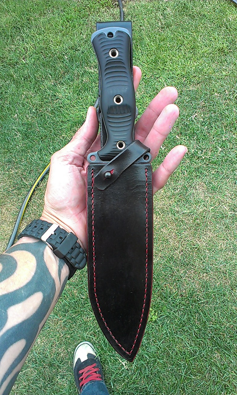

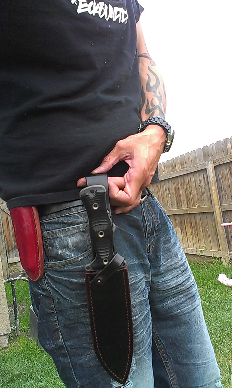

Looks good on me. Yeah, after messing with this thing I'm pretty sure I'm gonna need a Busse. :D
Very nice Strig buddy. That is a beast for sure. Got to say I like the red highlights. How come ya didn't do all the edges red? Think it might of been too much? I especial like how the red peeps through on the Sam Brown stud. Are you slicking your leather? Might consider it, it sometimes helps with those little wrinkles. Not always though. I'm gonna say two things I've said before. You need a creaser and you've come a very long ways REAL dang quick. Got to get some Tony Lamas or Justins on them feet too!
Nice.
I learned how to make leather sheaths because I started buying Busse's!
It has been a handy skill to have.
Thanks guys. :) I got my start because I needed sheaths too. Figured if I made a few it would cover the expense of the tools and materials. Haha still trying to break even. May never happen. :o
Dave, I didn't want to push my luck. I'm on this red and black kick. We'd agreed on all black but CM let me do the red accents. I didn't want to stray too far from the original plan. Thank you very much for the kind words. They mean a lot coming from you.

The sheath itself is a weapon. Fitting build for a wicked blade, can't wait to see what CM's scale has to say about this combo, well done.

Thanks Guest. The sheath itself isn't actually that heavy. I wouldn't notice it on my hip... well, at least without the knife in it. ;)

Edit- Forgot to answer your question Dave. I have not tried sticking, no. Well, that's not totally accurate. I sometimes slick a fold over belt loop with a little gum trag, but I haven't done it on the back of a front panel. Is this what you are referring to? Also, about the creaser, I know the tool, but what would it achieve on a sheath like this one? Would it crease a line on the outside of the stitch line (between the edge and stitching)? I know what the tool looks like, but I'm not sure about its function.

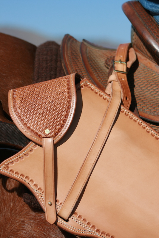

Tandy and BK both make glass slickers. I use a chunk of ligum vitae. Got it at Sheffield for about $7 or so . It was a knife handle block. Sand the edges round and smooth it up good and its a great slicker. When your leather is just starting to come back to color again from dampening it, rub it hard grain side up with your slicker on the stone. This will smooth out little surface imperfections and help with wrinkles etc. Also it compresses the fibers of the leather and makes the piece more consistent. Therefore your tooling is crisper and more even throughout your project. Its just another one of those little steps that makes a difference after a while. The creaser on this project I would of done the strap, the throat and the dangler. basicaly any edge that was not sewn. Check this pic, its creased around the throat of this holster.
In my opinion it just adds that extra bit of finish that sets it apart, makes it more professional.
Anthony, I hesitate to speak for Dave, but I think he was referring to the minor wrinkles in the first photo about 1 1/2 inches down on the right side there are four little wrinkles, and another over on the left. The slicking he is talking about is sometimes referred to as glassing. In fact the tool used most is made of heavy glass with a rounded polished very straight edge. It is used to stroke the VERY SLIGHTLY dampened and cased leather which tends to smooth out the wrinkles by compression. Use caution as it will also burnish if you go at it too hard.
A number 5 creaser will lay down a line about 1/8 inch from the edge, so yes if your stitch line is at about 1/4 inch from the edge the crease line would line up between the stitch and the edge. It gives a nice finished look to any project.

I figured it was the wrinkles that appear in the photo. I'll not let that happen again. :)

Por nada Paul. Does look like we were typing at the same time. Strig, just missed that deal on the briefcases. Tuned in a little late and they had already finished that segment. I've never used a glass slicker just my ligum vitae or a non descript piece of hardwood prior. Like you mentioned about the creasing, slicking just gives a subtle difference to it that your average consumer probablly could not describe. But I bet many would prefer it without being able to verbalize what it is. Creasing is the same. I don't crese sewn edges very often. But almost all non sewn edges. To me, often a creased and sewn edge is almost too busy. Now this doesn't make it wrong, just a personal taste deal probably more than anything. I see it on belts a lot. That pic of my creaser I sent you is an Osborne #5. Nichole stole it and I've been regulated to the adjustable Tandy one she bought some months back and didn't like. I like it, so it worked out ok. But that Osborne does help to round it a little bit whereas the Tandy does not. I couldn't find the pic that I was looking for to show you but this one will have to do: This is one of my flapped saddle scabbards for a scoped rifle. Notice the creasing on the strap to the Sam Brown stud and also on the straps for saddle attachment. They are all creased and it just dresses it up just a little. The scabbard itself is completely lined so no creasing on it.
