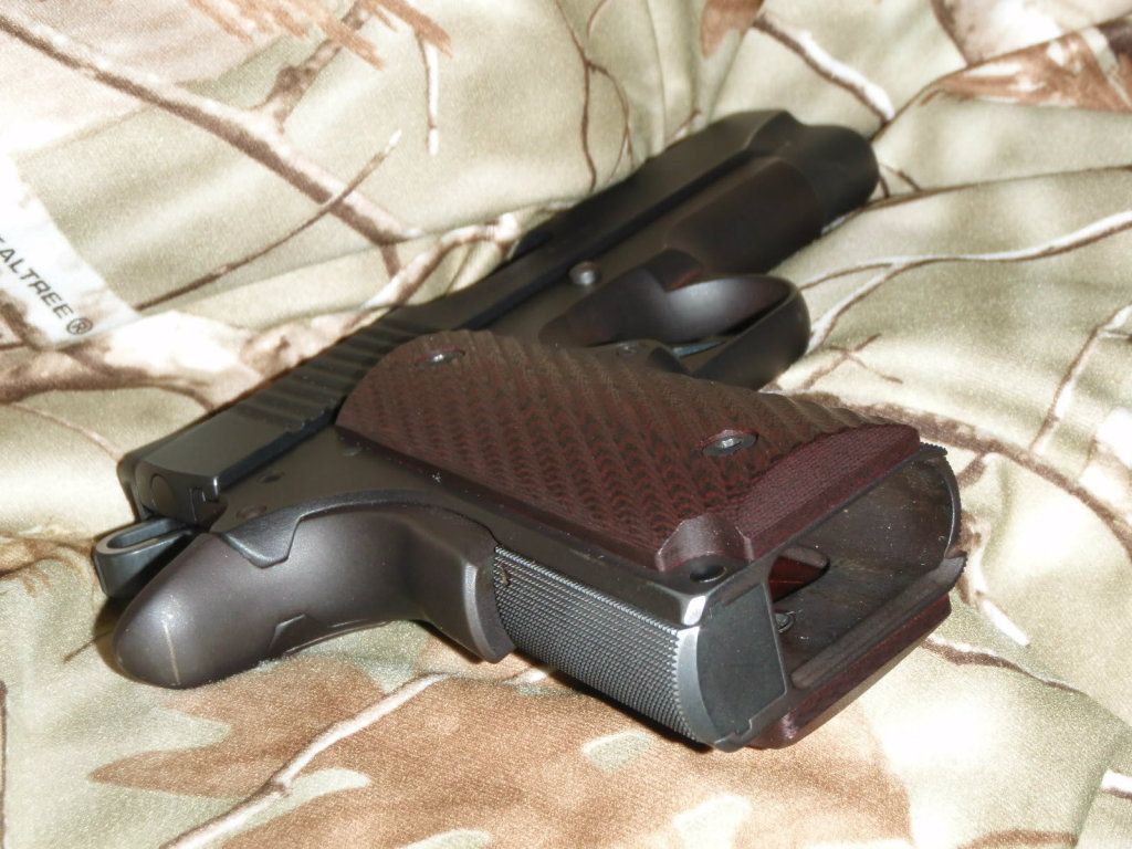

I noticed the difference in the G10 color layers when I had some red/black G10 gun grips made. I naively expected the G10 to looks like Busse's, as I thought they just bought it from a manufacturer. The single layer of red barely shows up between the black layers, and I was a bit disappointed with the way they turned out (I was hoping they would look similar to rosewood in overall color). I ended up dying the grip panels for about 2 hours in a simmering pot of some dark red RIT dye. It did help the red show up better, but the grips have a slight pinkish hue now and they still don't look as good as the Busse red/black.
A good shot of my grips. You can easily see how thin the color layers are in this standard G10 (from Alpha Knife supply iirc). The only way to really see the layers is to look at it from the edge like this.
Typical Busse red/black. The layers are easily visible even from the top.
My grips from the side (and the gun after a little custom work and being refinished in DLC :D). See how the colors basically blend together?
Anyway, as far as I am concerned, Busse's G10 is the BEST there is!!!
