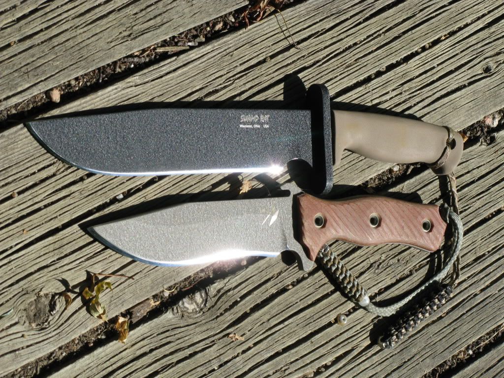

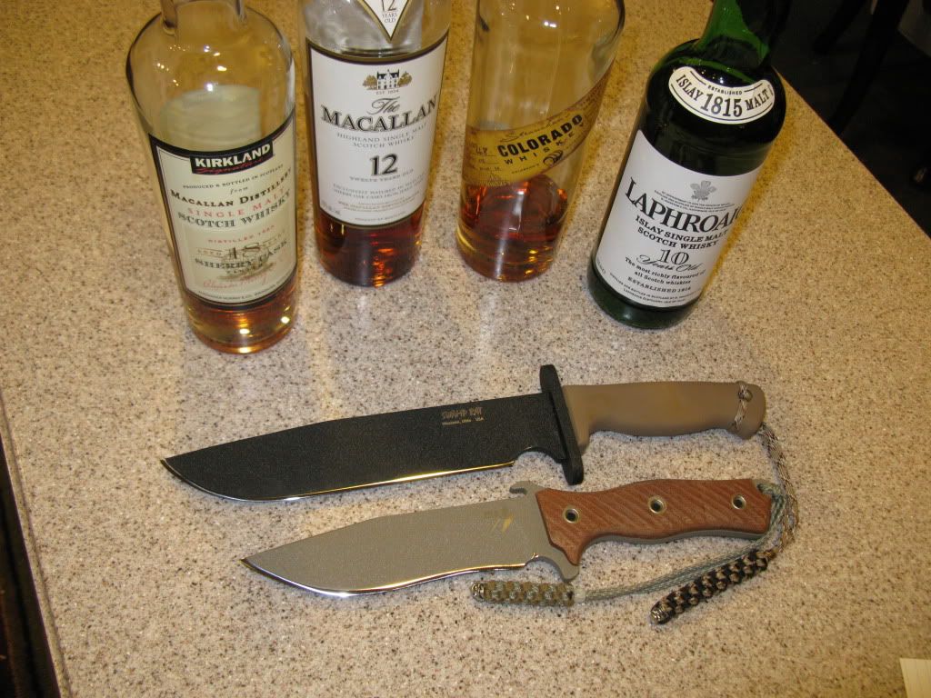

I have been practicing convex sharpening for a few months now, and have gradually worked my way up to some of my largest and most expensive blades. The guide posted by Jerry Hossom (and related forums threads) along with Youtube were paramount in my learning. I started out with a bunch of cheapy old kitchen knives I bought at Goodwill for about $1 each. I think that practice paid HUGE dividends in the end. I am currently using the cheapy Harbor Freight 1" x 30" belt sander (which I just happened to already have), along with belts purchased online from TruGrit. I am using an old, basic, worn out 220 grit Aluminum Oxide belt to initially reprofile, then Trizact 65 micron (~300 grit), then Trizact 30 micron (~600 grit), next moving to 15 micron Norax (~1,200 grit), and finishing off by polishing on a leather belt (SurgiSharp) with green Chromium Oxide compound. All the belts I am using are cloth backed (except for the leather of course). I plan to buy some 5 micron (~3,000 grit) belts and some white compound with my next order to get that extra bit more out of the process.
For the record, the top knife is a Battle Guard, and the bottom one is an EH3 Mini Mojo (from Knoboganza Spring 2007 I believe). I bought both of these second hand here. These are my big game and small game hunting knives, and both sport sweet, sweet leather sheaths from Dwayne at Armoralleather.
The knives are sharp enough to literally shave off my finger prints, especially the EH3. They can chop pieces off of free hanging hair quite easily as well. FREAKIN INSANE!!! :eek: I put a slightly more obtuse edge on the Battle Guard, to help it hold up better to chopping tasks. The results can be seen here.

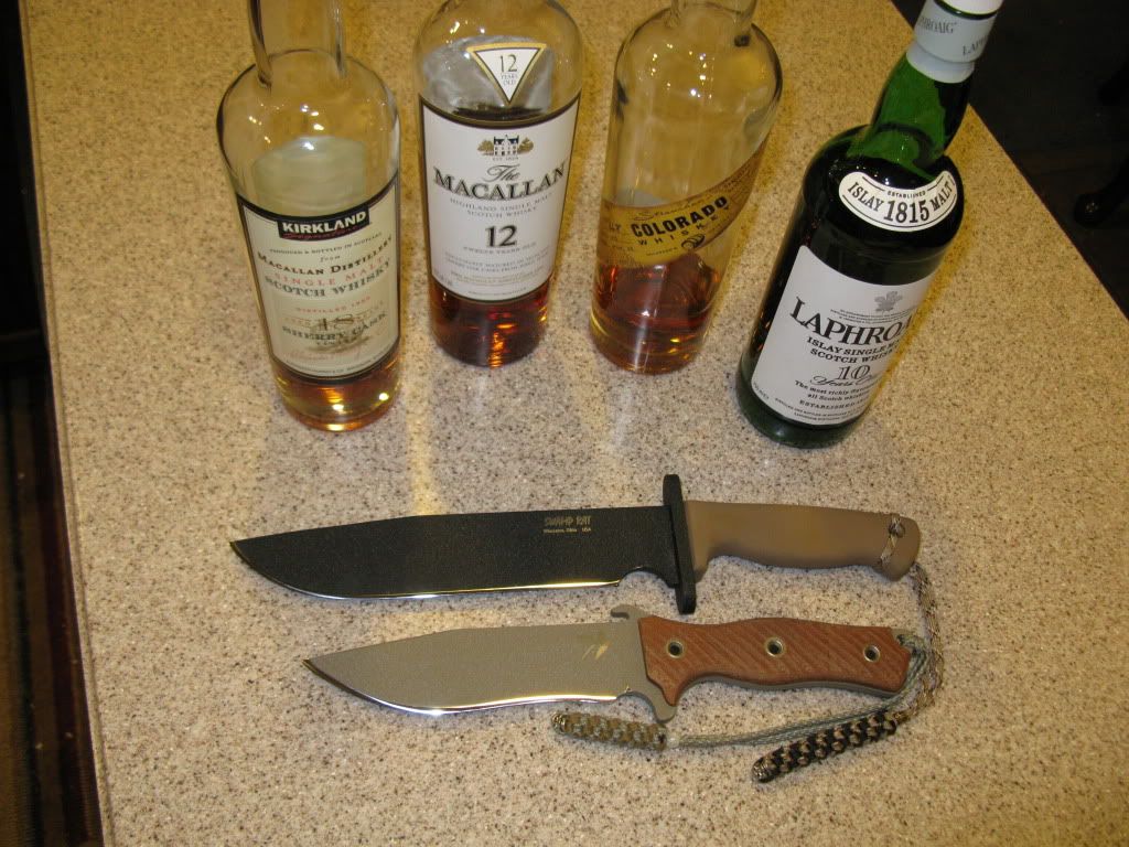

A couple Busse forum appropriate shots with some of my favorite libations (man, looks like I'm getting low... The AlaskaGanza killed 'em! :rolleyes:).
One thing I learned is that these reflective edges are a pain in the rear to photograph! I might try tomorrow to get some out in the daylight and see if they turn out better. Hope you enjoy!!! :D
Thanks! It took some chutzpa to take these to a belt sander! I love the results though! Can't wait to try it on the Rucki! :D

Two things, is there a particular step-by-step thread you used?
And...
How far did you need to take the egde up to get it perfect? In other words, when you reprofile the edge, how much blade height do you lose?

If you google "sharpening my way" along with "Jerry Hossom", you will find the thread I mentioned. I think that LONG thread has the most information consolidated into one location. You can also google "belt sander sharpening" for a lot of other info. Some good stuff to be found here as well. Just about every possible question about convexing this way has been asked and answered at length already if you just search.
If you are careful when reprofiling, you won't lose any real measurable blade height or length. If you do, you are going too fast! If you go slowly and watch for the wire edge to form, I can't imagine losing more than about 1mm absolute MAX. Since I was moving to a more acute edge geometry, all I was doing was removing the shoulder and ideally no metal at the edge. One hint is to use a coarser grit to reprofile, as while it removes steel faster, it also won't heat the edge as quickly while doing it. My worn out 220 grit is just about perfect for this task. Again, go slowly, but keep the edge moving. I'd say no slower than about 1" per second, and check the edge after each pass, while also cooling it in some water.

I tried that method ONCE. It took WAY too long, and I just don't have that much free time or patience. Using the HF belt sander works just as well (maybe even better) than the sandpaper method, and is a LOT faster! I think each of these took me an hour at most from start to finish, including reprofiling the new angles on them. What is even better, now I can touch up my my kitchen knives (and my Dad's, and my in-law's) in a FRACTION of the time it used to take me with my Spyderco sharpener (which I am extremely proficient with).

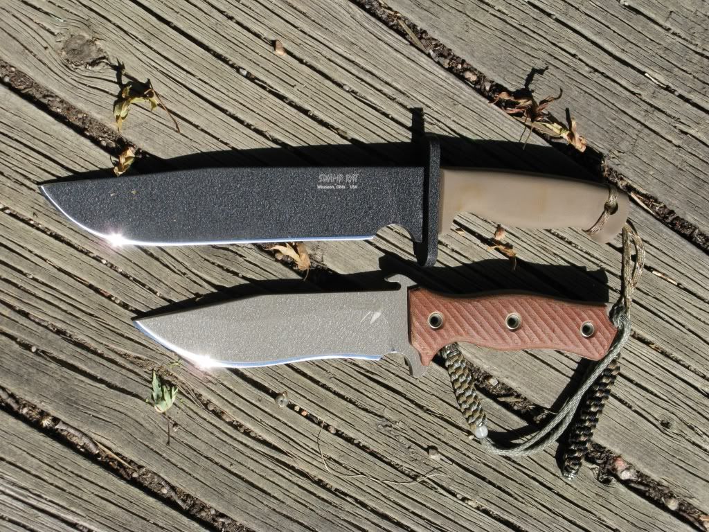

Got some better pics in the sun today, but I'm headed out the door to take the kids fishing for a bit. Will post them later. Also, I forgot to show you guys my version of the penetrator tip, so got pics of that too.
Slider, the Kirkland Sig. Scotch is fantastic! I'll tell you more about it later as well.
So here are the better pictures I promised! BEAUTIFUL day here today!!!

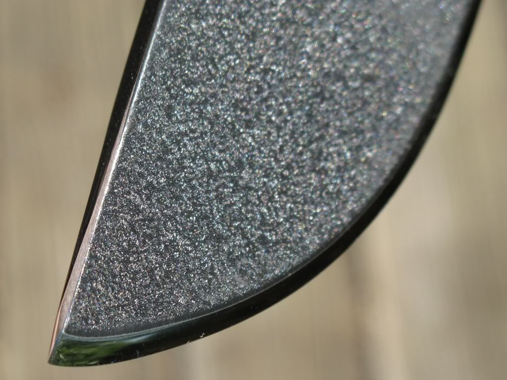

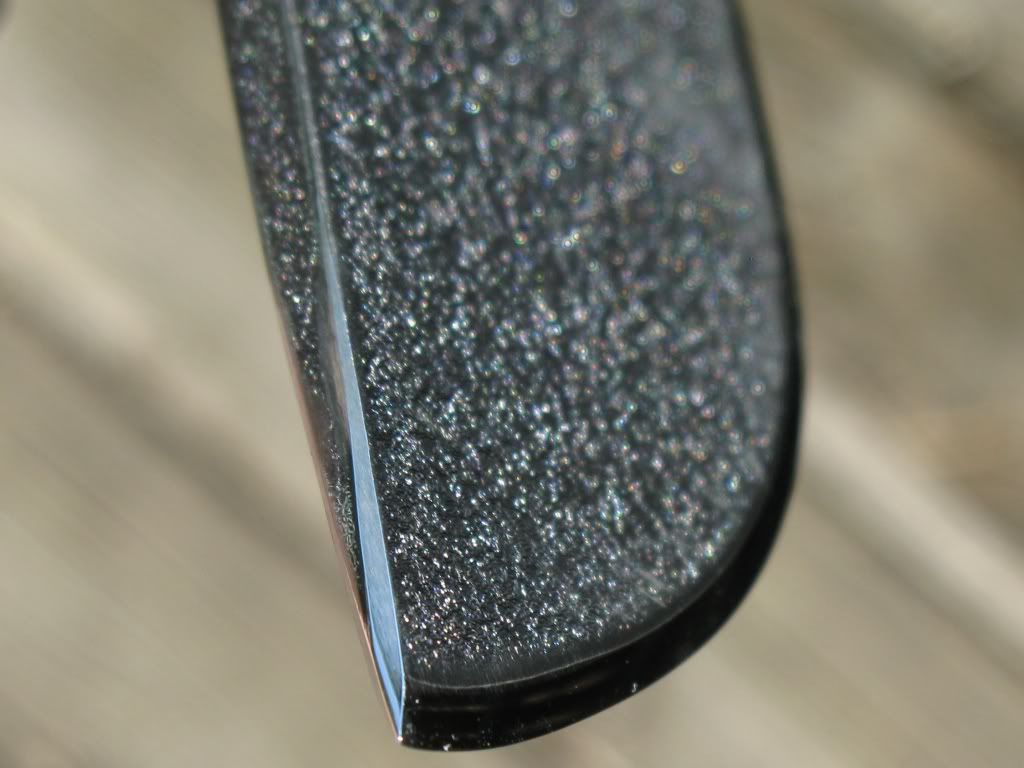

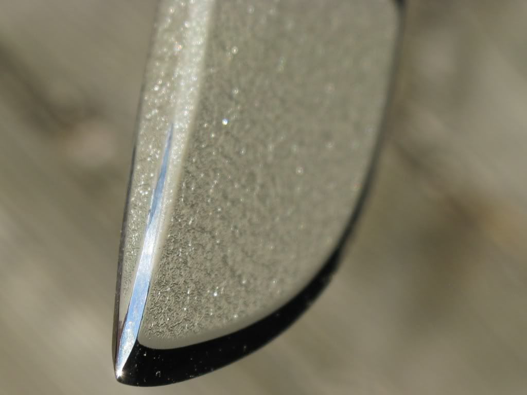

Here are pictures of my version of Busse's "penetrator tip". I have a VERY expensive diamond coated grinding wheel from back in my days of working in the optical business which was used to edge lenses for eyeglasses. I worked for a cookie-cutter chain optics store for a short period (when I got layed off from my lab job at the largest one in Denver), and they threw these things out regularly when they got new ones in, whether they were used up or bad or not (these wheels cost thousands of dollars!!!). The wheel I have is heavy bronze 10" in diameter, 2" wide, and has about a 1/8" layer of diamond grit coating on it (~700 grit), with a small 75 degree V-shaped groove in it for putting the edge on a lens which then holds it in an eyeglass frame. This groove is PERFECT for adding a small bevel to the tip of a knife to aid in penetration. :D After adding the bevel, I buff it a little bit on my leather belt with green compound. The bevels on these two knives gradually taper back to about an inch from the tip. Here are some close-up pics of my penetrator tips on these, to give you an idea of what they look like:

Thank you! The Mini Mojo's recurved edge was especially tricky! I swear, it was like dancin' with it the way I had to keep it movin'! ;)
