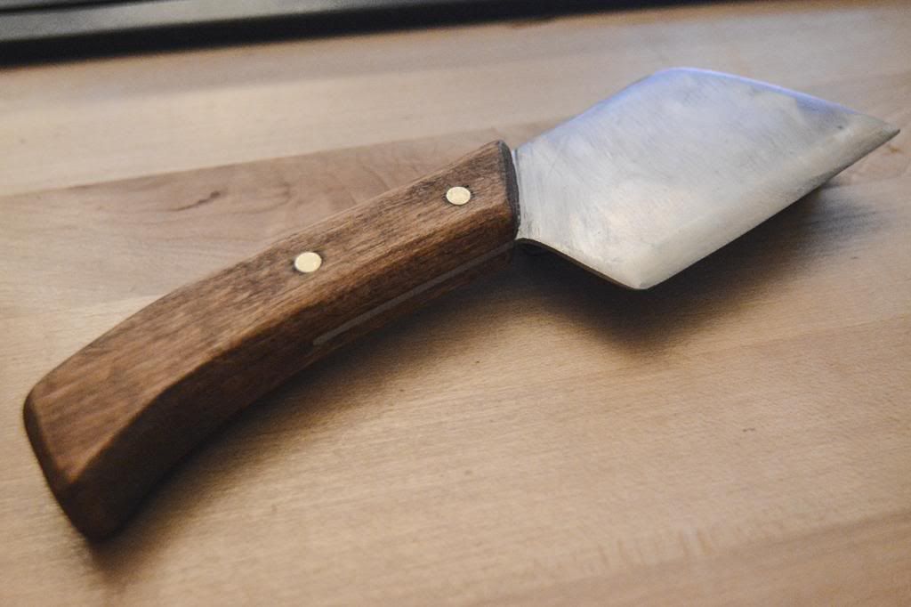

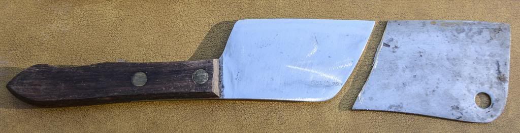

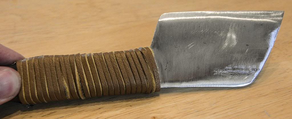

I made this from an old butcher knife I found my basement. Leather shoelace pic was a prototype/temporary handle.
Blade is now 3.25" long, 2" wide.

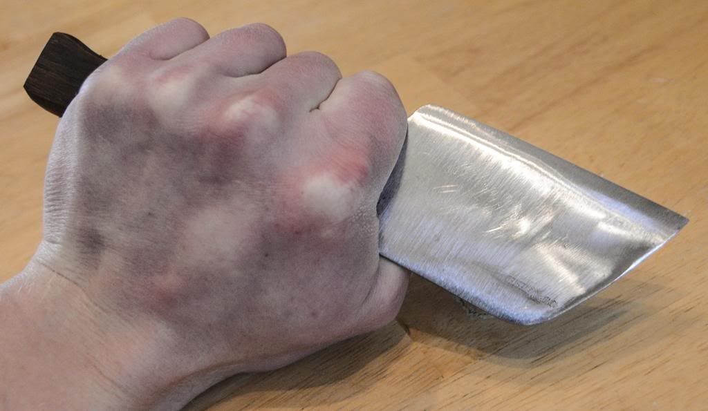

I like the way a fatter blade can be handled and stabilized. I find it odd that it is so rare to find a fat bladed knife. With the back of the blade being flat, you can hold the knife at more angles, and can use it for splitting small pieces of wood etc.

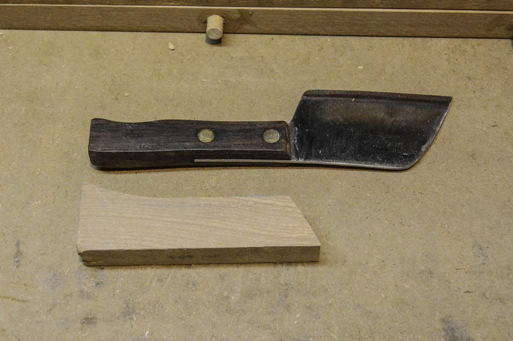

Handle made out of Oak? Not sure- I picked up scraps from a high-end woodworking company.

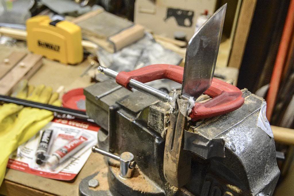

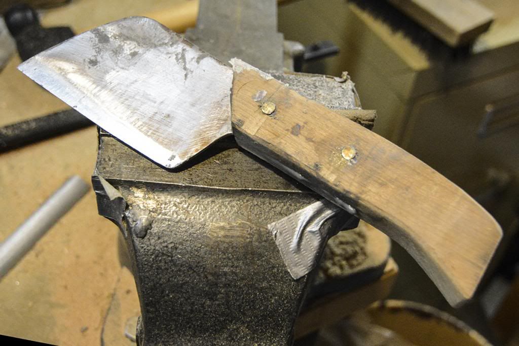

Cut down the middle, Epoxy & Brass pins applied
Out of the vice after 24 hours

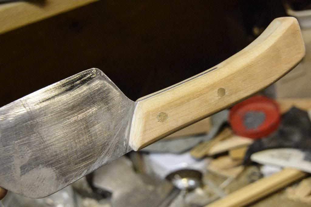

Filed down

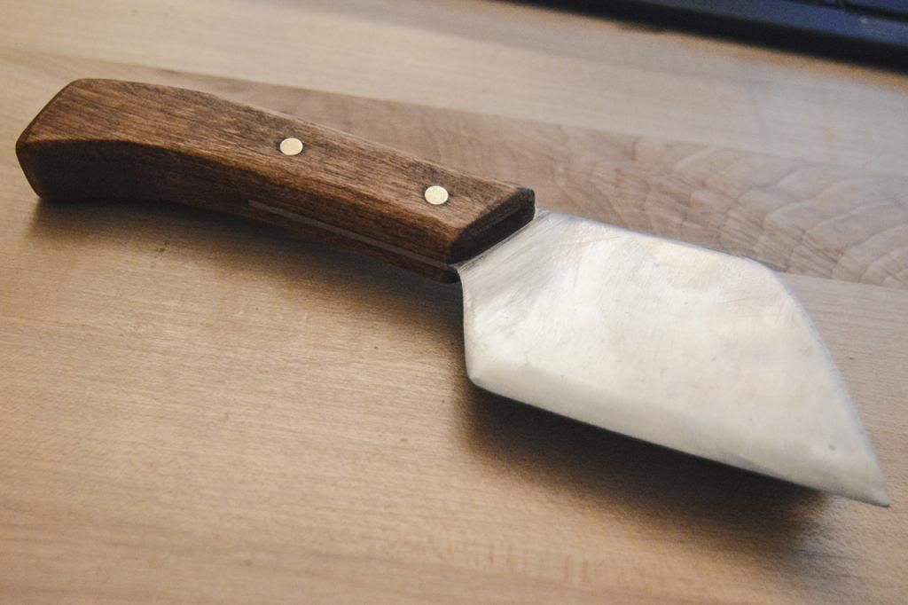

Stained with Watco "Medium Walnut" oil finish
Thoughts?
Should I cut anything else out of the blade to make a multi-function design? (Bottle opener, etc)
I think that is pretty slick. Good job!

mine has been working pretty well. Easy to hold close to the blade. I've used it lightly as a chisel for certain things.
