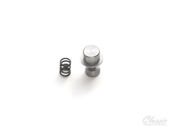

does anybody have a schemaic of how a button lock works? i mean.. i understand the principle.. but how do you do it?

http://www.knifekits.com/vcom/product_info.php?cPath=1_13&products_id=20
If you buy one, you have it in your hand.
Th website also has detailed photos of the parts, and sells the lock parts separately too.
http://www.knifekits.com/vcom/index.php?cPath=60_90
The tapered portion of the part is pulled into a drilled cutout on the tang with spring pressure. When the button is pressed, the smaller diameter lines up in the hole and has clearance- allowing the blade to open.
Just one cutout for locked open, two cutouts for locked open or closed(auto)
I understand how the actual lock works. but i dont understand were the spring goes in the knife....how can that be in the frame without it interfering with the lock?
also, can you have two cut-outs to keep the blade closed instead of using a detent ball? or how do you keep it closed?
thanks so much for the silly questions
~chris
Just my guess, Chris, but I believe the spring goes between the bolster and the bottom of the pictured button on the opposite side of the knife from the button. Probably a small recess for the spring in the bolster and in the bottom of the button. It is never within the operation portion of the knife to interfere, just tucked away in the bolster. Bolster/spring/button bottom......blade.
And you should be able to notch the blade to accept the button lock to lock open and locked closed. Push the button to release and allow it to open. Be careful about your state's knifes laws regarding gravity knives.

Exactly what Nathan said... It would really help you to have a kit knife in hand such as the one Steven Penner suggested. That's what I started with before making my first button lock. Made all the difference in the world to SEE it.

I couldn't find the directions for my DDR3, but IIRC they weren't very helpful anyway. Therefore, I took my DDR3 apart and took some pictures for you. Mine is the auto version, but it uses the same button lock. Essentially, the button lock parts are contained in (or recessed into) the handle bolsters. Hopefully, the pictures will help explain things. (Sorry about the crappiness of the images.)
The knife disassembled.
The button passed through the bolster.
The coil spring removed.
As you can see, the coil spring is recessed into the right bolster, and one end of it hooks into the blade itself. The far (bell shaped) end of the button lock also goes into the right bolster, and the spring under it pushes off that right bolster.
