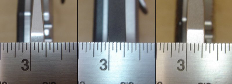

Toughest will probably be the 0560. It has a thicker and wider blade than the 0566. As has been mentioned, the newer 0560's also have the steel lockbar insert, so you can always ask the dealer before you buy it if it is one of the newer ones. None of my 0560's have the lockbar insert, and they've held up just fine.
There are some pics of an 0550, 0560, 0566, and 0562 in the first look thread: posts #433 and #483.
Here are a couple of side-by-sides I took a while back showing the 0550, 0560, and 0566:

Sweet, thanks for the pics, and all the replys so far. Curious though, what would make the 03XX series so much stronger and tougher than the hinderer collabs.? The lock bars seem to be the same thickness. The only difference I see is the blade width. Im guessing my choice should sway towards the 0560/61. I have always wanted one, just need to find one with the steel insert.

Not much really, 560/1 has pocket milled scales to reduce weight and KVT. 3XX liners are solid IIRC, and they use washers(less chance of getting the pivot gummed/gritted up). I think the hinderer collabs carry easier and better than the strider/onion ones. Also IMO if your want the toughest of the the tough folding ZT hunt down a MUDD. :D
