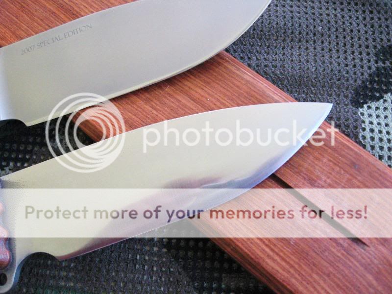

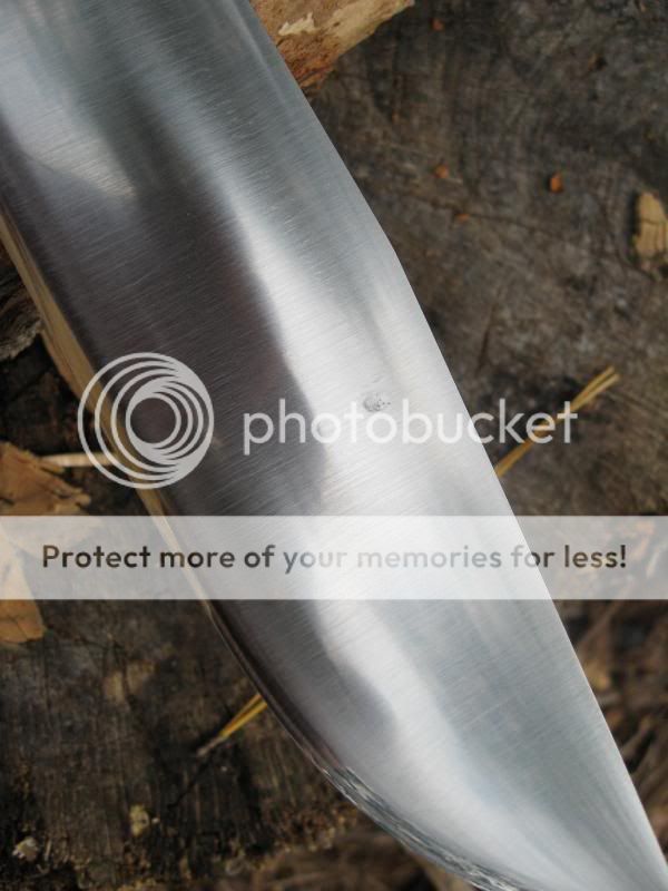

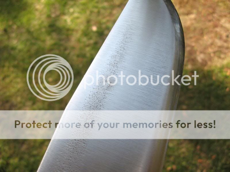

When I stripped mine i had a few along the upper third of the blade. Nothing too deep though. Horndog got rid of all of the dimples on his. I kept them cuz i like the look of them.
Cool, I don't mind a little character, I just didn't know if it would be so bad I'd have to thin the blade any. I def. don't want to make it any thinner.
Mine was pretty rough under the coating, but I'm sure it varies.
But I eventually got most of the dimples out.

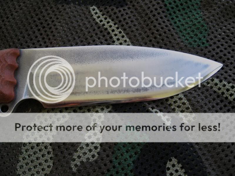

The convex main grind starts somewhere below the spine, and in that upper area you'll probably have the dimples. Here's a shot of my Skinny ASH right after stripping it. You can see the dimples up top and the vertical lines in the main convex grind. Those lines are not terribly deep, but INFI is hard, so it'll probably take more than a little sanding to smooth it all out. ;)

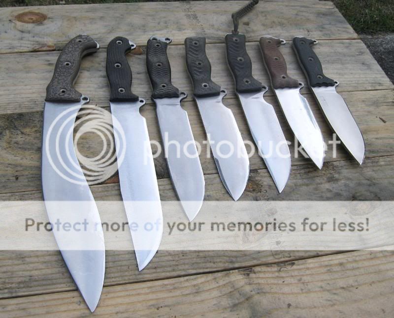

The best way is to remove the scales and use the platen to sand the ricasso and pommel flat. Then send the knife and scales to Busse to have them put back on. But I never bothered to worry about the dimples there. I just buffed them with a Scotchbrite wheel and called it done. All my Busses are done that way except for the LEs and my green BWM. I have done it on Ranger and RAT Cutlery knives that have removable scales.
Then go for it. It really isn't necessary, but some of us like naked INFI and are too cheap to buy the pretty LEs. :D

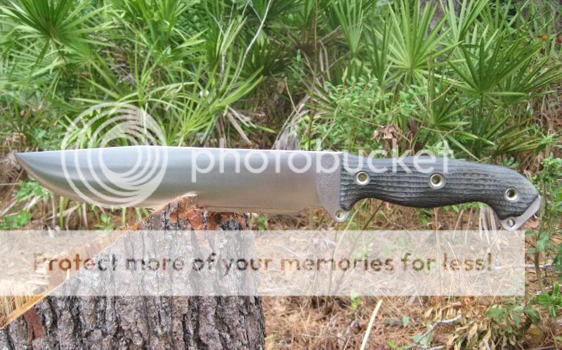

You did a heck of a job on the Squatch Bowie
You have some of my favorites HD:thumbup:
Thanks, knife hunter. The Squatch Bowie was an accident. I was trying to sharpen the swedge and things got out of hand. It looked terrible, so I did a long clip point to erase my mistake. Now it is one of my favorites.
