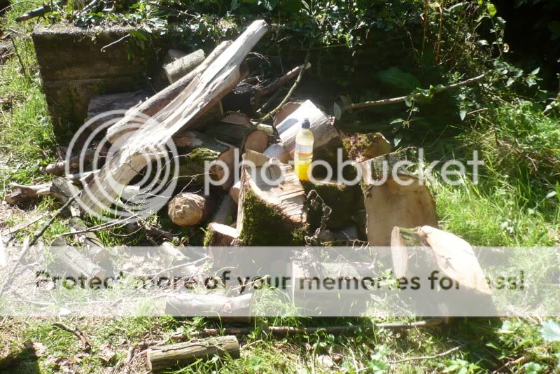

Some of you may remember this pic of a tree which has died where I took the missing limb down with the Basic 11 and the TTKZ ....
Well the remaining limb overhung the dry stone wall at the rear ( not easy to see in the above pic but it is there ) so this weekend I decided to bring it down safely. To drop it where I wanted I need to use a chain saw with a very deep slanting cut to get it to fall back against the natural lean .... I managed to do it and then sectioned up the trunk .... this left a fair old bit of wood needing chopping up .... which is pictured below ....
Cutting down the remaining limb with a chainsaw also enabled me to flatten off the stump to give me a long wanted proper chopping block ....

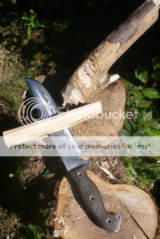

Anyway .... a little put off by realising this potential problem I started getting stuck into doing some serious "log splitting" .... using a baton it was'nt long before we had a large cardboard box full of firewood for storing for the winter ....
You can see in the pic above my BWM CG ... the reason for adding this one to the equation was that as I was getting into this splitting .... and I must have been going for a good few hours by then .... was that I was becoming conscious that the shape of the grind seemed to dominate "performance" .... or so it seemed ... with the BWM LE being the best out of the Basic 11 and the Damura .... but I knew it was also the thinnest of the three at .220" and therefore brought out the thinner still BWM CG at .187" to see how things compared .... the Basic 11 is .25" and the Damura is .275" ....
The BWM CG was interesting to use ....
In splitting the thinner sticks it was at it's best, very quick and able to benefit from it's thinness ... but with the thicker logs it tended to stick more midway .... this was when the advantage of the sabre grind on the BWM LE with a wider spine seemed to help open up the log .... the Basic 11 at .25 thick was equally good but I think the painted finish seems to offer up more resistance than a satin finish and the depth of the BWM LE also seemed to make for a more gradual taper which whilst things were very close .... definately gave the BWM LE an edge .... you need to do a lot of batoning to tell .... a lot of it back to back using the same piece of wood ... but you do notice the differences when you do it for hours.
The Damura at .275" thick at the spine was pretty good on the bigger stuff but it needed a few more initial whacks to get it going .... it is suprising how much it reminded me of the TTKZ grind when I first got it .... and unlike the TTKZ which with a satin finish was easy to tweak on a belt sander .... the lovely finish on the Damura has me scratching my head a little as to what to do

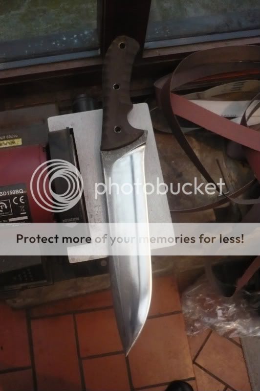

It is a complicated grind to alter .... the grind line at the choil is sloping and not vertical and the area where you would want to thin the sides down is more or les right where the darker etching ends .... this would lead to a bit of a bright transition from etching to satin created by the belts .... the only option I can think of being to double cut the finish and have a uniform but less pretty look to the knife .... or simply leave it as is .... but that hardly appeals to me at all .... or to send it back to Japan to try to explain the modifications I would like .... and again I cannot see that being a success either ....
It would cost a lot of money for what is a relatively quick job compared to the travel time etc with the knife ....
I guess I will just do the job and see what I end up with .... I much prefer a knife to work really well than worry about it's looks ....
