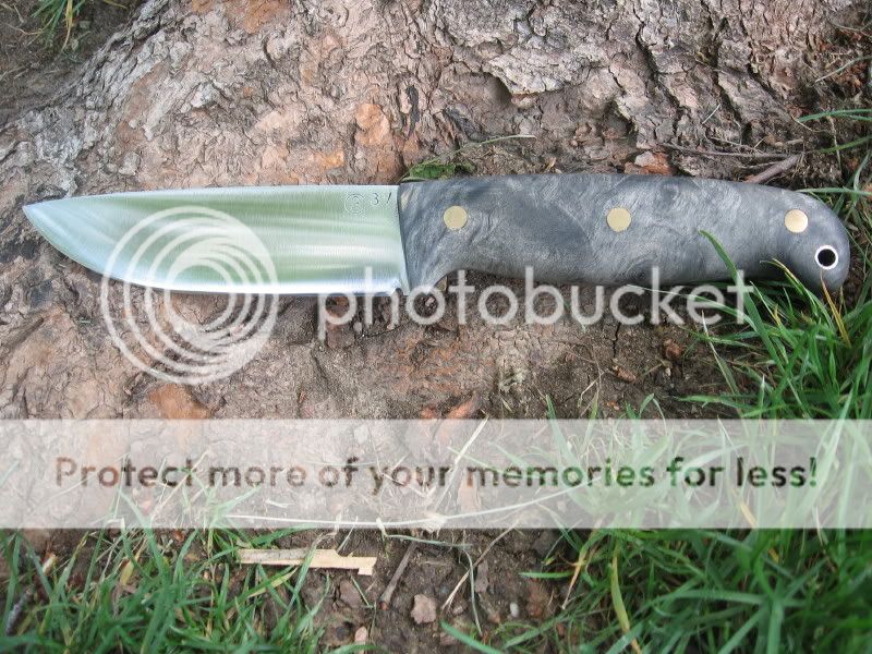

Hey Fellas, here is the new C3 Bushkiller in 3V. After the bushcraft knife challange, I took the reviews and made the adjustments needed. Here she is. I'll be doing an ongoing review of this one. 6 Months or so.
Fully convexed with a thin convexed secondary bevel. It's a laser with the steel to support it... Buckeye burl, corby bolts, 5/32" cpm 3V stock. HT and tested at 58 RC. Will be doing a run of these in the next few weeks. Design is at the water jet cutter now. They will be done at the same time as the Colorado Belt Knife. Intro of that one here. http://www.youtube.com/user/C3Knives?feature=mhee#p/a/u/2/AzD7iTUyU1w Thanks for lookin...
