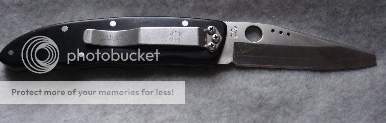

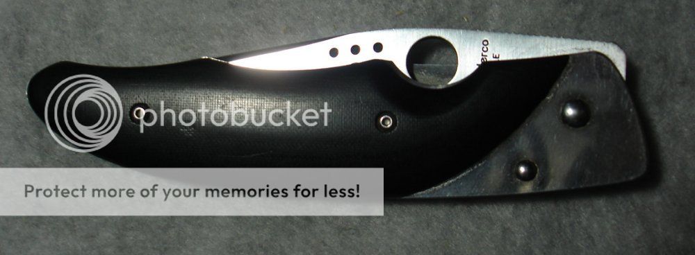

I picked this up fairly cheap for a reason. As you can see someone did what they shouldn't and used the tip for, who knows what and now it's broken. My original intention is to turn the blade into a Wharncliffe as I have done with other broken blades.
But my question is this, should I send it to Spyderco for the other issue before doing it or just Wharncliffe it as I wanted to and use it.

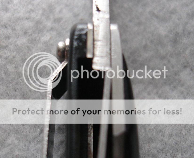

As you can see in one picture the lock bar travels all the way to the far side of the blade.
I'm sure there is really nothing that can be done with this old model but I am wondering if any of you have had any experience with such a thing and what Spyderco's response might be. I believe a e-mail would be the easiest way to pose the question rather than paying to have it shipped to get a reply.
Other than the tip it's a great knife.
Personally I wouldn't reprofile this into a wharncliffe. I think the nice clean swedge on the spine if the blade should be preserved as much as possible. I would reprofile the blade to add some belly and curve up to meat the swedge. Not alot that I think can be done for a 100% lockup though. Does it stick when unlocking or does the blade have vertical blade play? If not, I'd just reprofile the blade and not worry about the lockup.

I've had 2 of 'em and the liner lock did the same thing on both, these were meant to be a Gentlemans knife and as such were not meant for har use, personally I can overlook the liner lock issue as I only use it for eatin' out or very light work, I've never had the lock fail and 'cause of how far over they are if they failed it would probably jam the blade in the open position anyway.

Pity to see this one broken... maybe you could put a blunt nose on it similar to the Caspian?
The second generation of the original Viele was superb. It's one of the knives I had to sell when I was unemployed a few years back and I miss it a lot. It had thicker liners and better materials throughout solving the problems the original had (early wear causing the lock to go all the way across the tang with no way to adjust it). I've kept my eyes open for a second gen on the used market but haven't found one. I may just buy one of the 2's and try it out.
