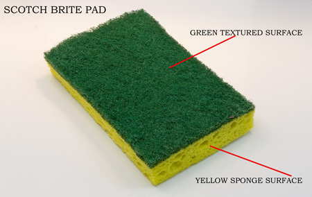

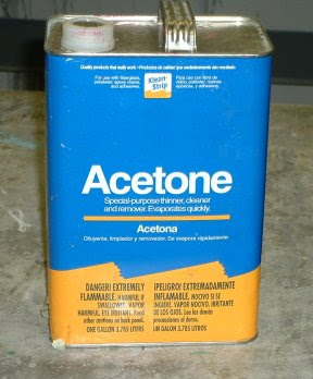

I did this:
There is still a faint image on the blade, so I may try again. Go slow.

The ones I removed the logo on, I just used a razor blade and scraped the logo off, VERY carefully almost keeping the razorblade parallel to the side of the knife blade. Then a little acetone, and buffed with flitz. Logo and "shadow" gone!
BTW, the logo is screen printed on or something, it isnt a sticker.
