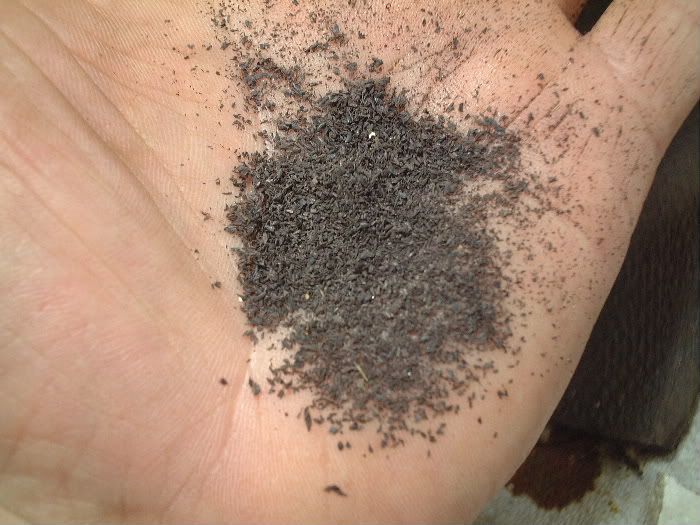

To answer the original question. The Nicholson cabinet makers files are expensive even though they are now made in Brazil, but they are a very nice tool. They leave a fishing that is very easy to sand smooth. karl Anderson turned me onto them a few years back. The really isn't much of a difference between the #49 and #50, at least for our purposes.

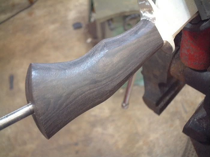

Tell you what, I've been using my #49 and #50 almost exclusively for well over a decade. And I am still using them on virtually every knife today. And I have been a full time maker for over 5 years and quite prolific even before that.
It was a one time cost.
Grinding belts are bought and replaced over and over.
And they cut so sharp and so crisply that I am in control all the time, with each and every stroke and never get in trouble.
They EAT!!!!!!!!! wood, micarta, stag, ivory, etc.

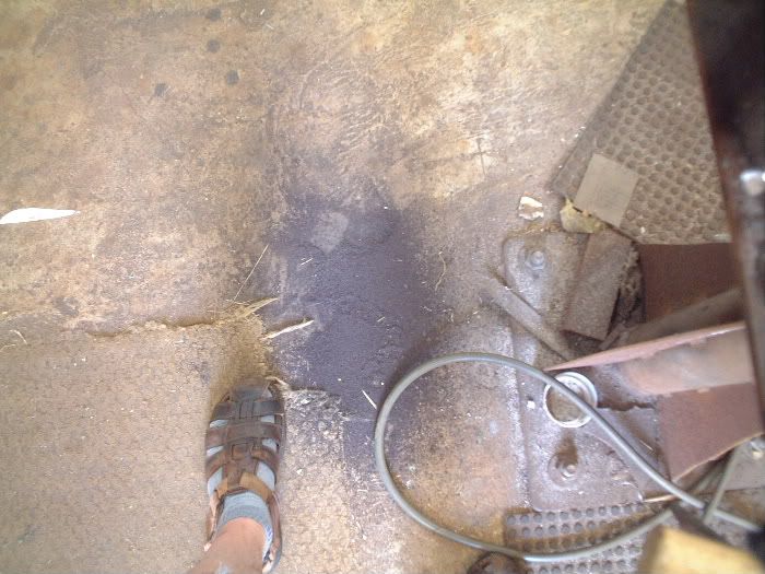

this is on the floor at my feet:

Karl, I have had one for at least 5 years and gave one of them as a gift to a fellow maker who helped me out with some stuff back in 2013. I was hesitant to tell anyone that they are probably okay for some composites like Micarta because I have only used them on natural and stablized wood, but there you go. ;) It was also you who clued me into the fact that they leave a very easy to deal with "rough" surface finish that to me is much easier to smooth out than say 36 griit belt scratches. The close up picture that you posted shows that very well. :thumbup:
