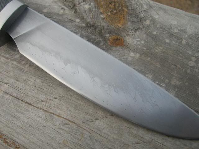

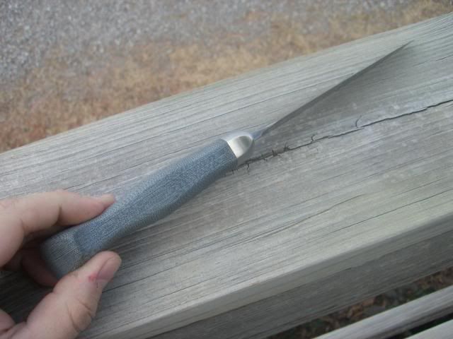

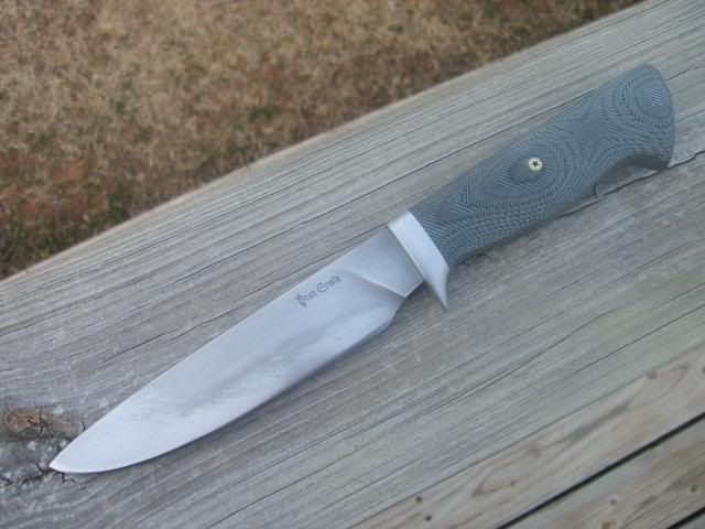

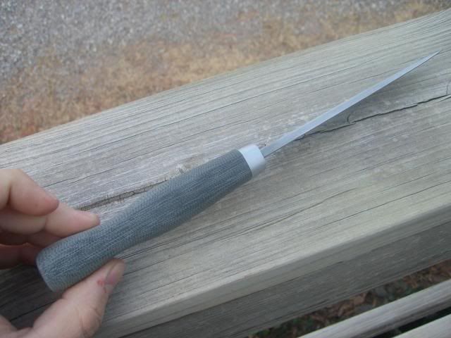

Here's the second knife of the order : Still working on the other two
Blade : 1" cable forged into a differentially heat treated blade.
Guard : 416 Stainless
Handle : Olive Twill Homemade Micarta with a mosaic pin
This one I was also pleased with how it turned out. Had a small divot on the top of the spine edge that I'd came up with a remedy for, which also makes a pretty cool feature. I just added small bevels down both sides of the blade along the spine which removed the little mark and added additional facets that play with the light when the blade is moved around.
Bought a little 2x42 sander which I may end up making some modifications to, but it's job was for shaping handles more interestingly. Which it does pretty well, just have to use it some more to learn it's limits. If I'm able to make some modifications that I'm thinking about, it'll make it a bit more versatile. So I did even more sculpting on the handle of this one giving it more contours. Also feels great in hand.
Questions and comments welcome.
