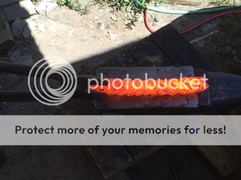

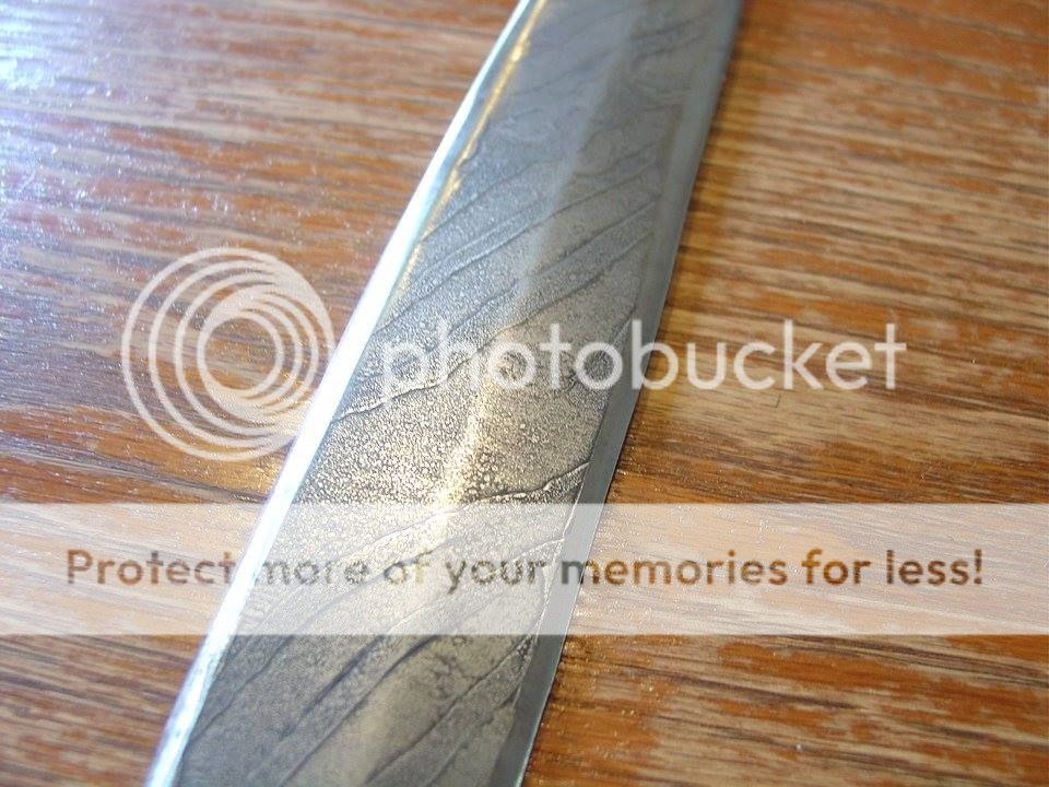

This is my second cable damascus. This one was using a serious piece of steel cable. I put a lot more effort into the handle on this one as well.
Before:
During:
After:

I would suggest you work on your blade/handle shape and fit and finish more now.
The knife shown looks sort of cool for a pirate costume, but not very good for a user or for hunting.
I would recommend you look at some photos of knives and pick one by an accomplished maker. print out the photo, and make a knife roughly the same shape. This will teach you to form curves the way you ant them to go, not where the steel wants to move on its own.
I appreciate your taking the critique in the manner it was meant. I want to emphasise that I wasn't criticizing your efforts, just the final shape and some blade features. I think the knife shows serious skills. They just need a little refining.
I will point out a few places it could use some improvement:
1) The overall blade shape is what happens when you forge a tapered tip and the bevels in without pre-curving the bar, or correcting the rise on each heat. By curving the bar down in a banana shape, the tip will rise as the bevels are shaped and end up straight.
2) The transition from the edge to the handle is called the ricasso. Try and make a more defined transition with a small flat area before the handle. On this blade the problem was accentuated by the blade having a bulge in the center and reducing toward the ricasso. If the blade had a normal edge shape, the transition would have been more pronounced.
3) The edge sort of looks like it was just filed on ( including file marks). The whole bevel should taper toward the edge and only the actual cutting part be sharpened.
4) Nothing terrible wrong with the handle, but a little less palm swell, and more rounding would refine the shape. Your fit of the bolsters is very good. It looks like the handle and especially the fittings needed more sanding before polishing. I probably would have made the butt bolster a little shorter and had it drop down in a bird's head.
The best way to get the bevels looking more "crisp" is to file/sand/grind them flat to the spine after forging. Use a flat platen or a flat block backig your sandpaper. If they aren't flat, the whole knife will be off. Leave the edge at about .030" before HT and then re-sand the bevels after HT to end up arund >005-.010". That is what gets sharpened. By having the bevels flat, the edge sharpening line will be more straight.
The best way to get a knife to come out right is to start with a drawing. Use a photograph of a similar knife if you can't draw. Mark lengths and features, and plan on how you will get the final shape to come out right.
When drawing the knife on paper and in shaping it in steel - to get the blade to look more "normal", start with a straight edge. Lift the tip curve up slowly. You can take more off ... but can't put any back on. Blades only rarely need a bulge in the middle of the edge. Normally, the blade is fairly straight for most of the blade and then the tip rises, the spine drops, or both, to form the blade shape. A slight taper from the ricasso to where the tips starts forming is OK, but try and keep it small.
Imaging your knife with the blade straightened out and the width of the blade at the ricasso being the same as the middle - That would be one heck of a fighter.

Good looking welds on the cable. Did you forge it out by hand?
I did. I heated the cable up to melt out any oil or grease that was in it (and there was a lot), and then welded the ends. I heated it up, put it in a vise, and untwisted it to get the flux inside everything. I made a V-shaped trough to sit the in hardy hole on my anvil. I then heated it to forge welding temp and hammered it in the trough so it would not flatten out. I then put it back in the vise and tightened the twist, brushed it, fluxed it, and re-heated it. I repeated this process until I saw no loose strands of wire sticking out anywhere. I then heated it and hammered it until it was long and flat. I folded it in half lengthwise, fluxed it, heated it, and hammered it. I repeated this process until it was apparent that this weld took. I then heated and hammered it until it was in the shape I wanted.
