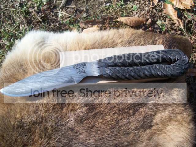

We are just plain ol' blacksmiths so we sctually sell a lot of cable knives with the rope for a handle..Kind of curiosity knives but good steel non-the-less..
Now the info you have already been given is good and the best ways to do it, but to be honest we dont take as much care in cleaning as most folks. We mostly use coal but havea gasser too. I put any cable in the gasser and heat the piss out of it. Take it out and slap it against the anvil. Do this about three times. It burns out the crud and whats left falls out when you slap it on the anvil. The I bring it up to welding heat. Now real fast, slap it in the vise and twist like your trying to break its neck :D You can actually weld cable like this if you want and your fast enough..Then we weld it in sections. You just kinda get a feel for the cable as it welds. I do several welding passes to get outt he voids..
heres one of those little cable knives we sell locally..Folks like em' ;)
