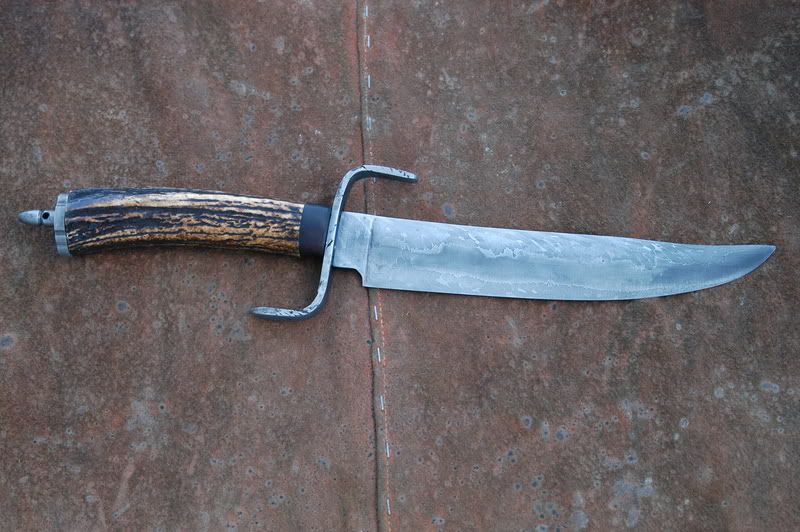

There is alot of first attempts here.First takedown knife,first good stag handle first good pictures(thanks to my sister) and first sale...well first trade.My tatto artist gave me a sketch and this is what I came up with.he wanted cable the rest was my choice.Next week I get a 1/2 sleeve

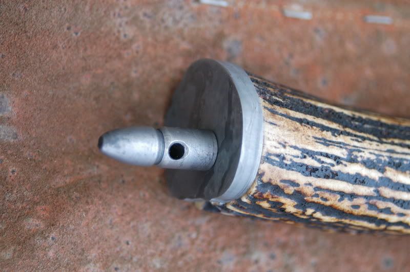

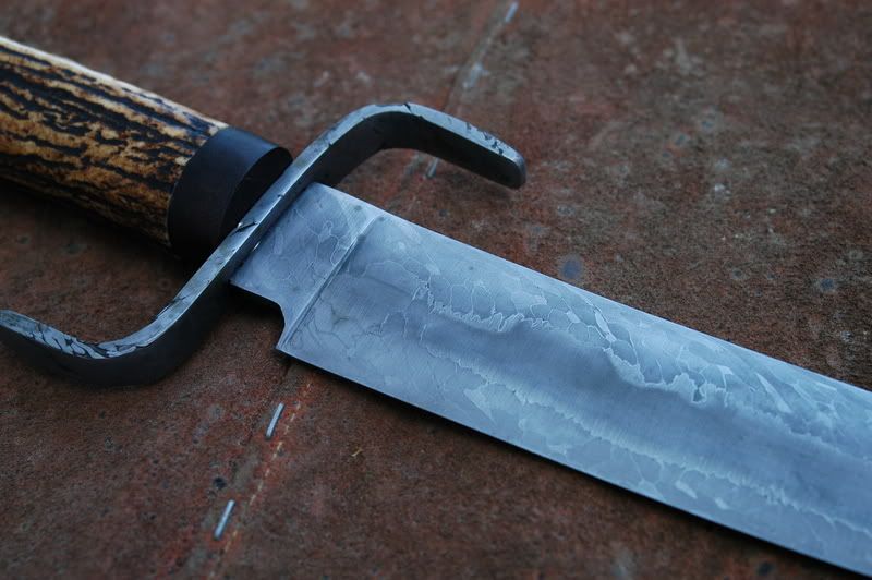

Crane cable with the core removed and a peice of 5/8" W2 put in,cable gaurd cable skull crusher, ironwood spacer and a frontier damascus cap.
