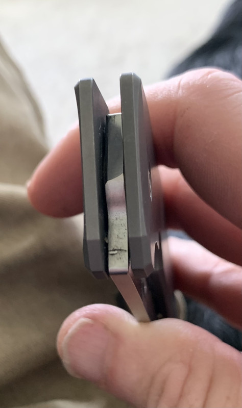

I just purchased my first Spyderco - a Spydiechef and I think I am in love with the design of this knife.
However, I do have a few questions that I am curious if the community can help me answer.
1) 1)My Spydiechef seems to have a bit of a gap on the back 2/3rds (or more) of the lock bar in open position. In other words, only the front section of the lockbar is interfacing with the tang. Is this normal lockup? Please see the following photo for example - note the gap between the lockbar and blade.
2) 2) I am also experiencing a bit of detent lash. In other words, when the blade is closed, before the knife even breaks the detent, the blade has play. The main concern here is that the blade tip can be pushed out enough to touch, even before the detent is broken. Also seems to be a bit of a sloppy execution. Someone suggested that this is common with the Chef. Have you experienced this on your examples?

Hi Tony!
The lockbar engagement on your Chef looks just like it does on mine. As far as the detent lash goes.. it looks to me like the blade is staying pretty well-seated within the handle until you actually start pulling on it and then returns to normal position when you let pressure off.. without actually feeling it for myself.. I personally don't think I'd be too concerned about it based on that video. I'd say as long as the lockup feels solid, then use it with confidence.

I've none of my other knives have exhibited these "behaviors" and I'm just trying to get an idea if the lockup is normal and if the lock rock is something to be concerned about.
From what I'm gathering, my lockup is normal. And the lock rock/ lash, while not ideal, is within the realm of acceptable.
R ricklikesknives , you are correct, the lock rock does not exhibit itself unless I try to manually pull on the spine of the knife.
When it comes down to it, while I would rather not have lock rock (and maybe a slightly more robust lockup), I do like the overall design of the knife and can live with it's flaws. I'll be keeping it.

OP - lock rock is annoying. It will perhaps not affect the use and safety of the knife but it is an issue that you should definitely reveal when you decide to sell it. IMO it is a defect on a knife of $200+. Unfortunately there is no easy fix for it, especially by the end user.

No detent lash on my sample.
My eyes and ambient lighting are too poor for me to see the lockup as you’ve done. From the witness mark on the tang, I’d say mine is doing something similar.
Hey folks. Just wanted to provide an update.
I ended up sending in my Spydiechef for warranty evaluation.
Spyderco went ahead and replaced the knife with a brand new one.
The new knife has both a more robust contact patch, as well as little to no detent lash/ play.
In any case, I am well pleased with the outcome. Thanks Spyderco!
