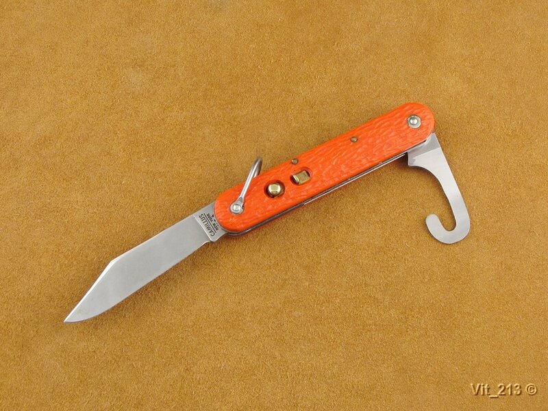

I just bought a camillus pilot switchblade with strap cutter. the switchblade has a strong spring but it doesnt lock open all of the time. does any one out there know how to fix this??
now I went to theweb and found a picture of a knife just like mine but mine is in much better condtion.

I stole a picture off the net because I didnt have time to take one. mine looks brand new. I just didnt get a box with it. can you please tell me what to do about fixing this please??

The MC-1 Paratrooper's knife was one of the most difficult knives made by Camillus. There are two notches milled into the tang of the blade for the blade to lock open and one to lock the blade closed. They have to be in the precise location for the knife to function properly. Many of the defective ones that were not scrapped are in circulation and were probably sold as seconds. I just repaired one for a collector that would not lock the blade in the closed position. This required replacing the blade with a new blade that had the notches milled in the correct position. Most likely this knife never worked properly from the day it was assembled. I have repaired many MC-1s and they are very tempermental. If you ever owned an MC-1 or worked on one you will understand why Camillus introduced the 18 X-Ray to replace it.

It's an old auto design- sometimes it helps if you push the button and move your thumb off of it as quickly as possible. Sometimes the blades will rebound just enough to not lock up right if you still have pressure on the button when it opens.
