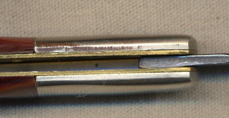

1) Camillus Barlow, single blade, 5" closed
This was an inexpensive closeout a couple of years ago. The blade action is very smooth, good "walk and talk", with no blade play at all. The handle material is a brown 'sawcut' plastic - could be Delrin, but doesn't feel as durable as the Schrade Old Timer handles. The big disappointments: the scales don't match up well to the liners. And the finish on the bolster (stainless? Nickel silver?) has been ground completely through on one edge, exposing the pot metal beneath.

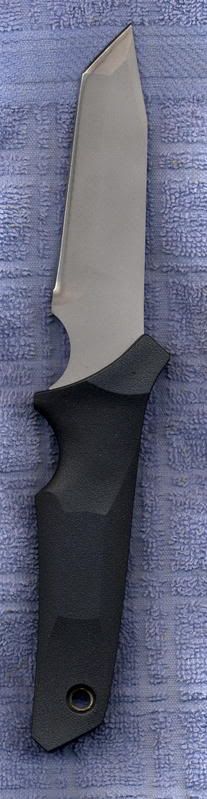

3) Camillus/Timberline Pilots Survival Knife
This knife is a cheap replica of the Timberline SpecWar. The blade itself is 440C and perhaps justifies the $30 closeout price. But otherwise it's not much of a knife. The plastic handle feels chincy, and the weight indicates that there's not much of a tang in there. There's also a small gap between the blade and handle, proving that the tang is only a fraction of the blade's width.
