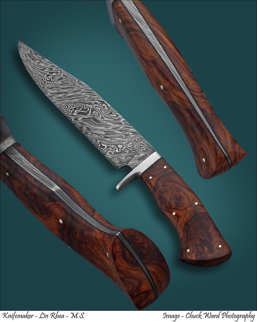

I recently finished a full tang knife that I want to share with you. I dont make many full tang knives and so I have to change my routine somewhat to make one.
The blade on this knife is 9 inches with an OAL of 14 inches.
The pattern is a type of twist and the steels are 1084 and 15N20.
The gaurd is 416 stainless.
The handle is Desert Ironwood with black liners.
I tapered and hollow ground the tang, which lightened the knife considerably. The blade thickness is slightly less than 1/4 inch about .240 or so at the ricasso and tapers both ways so it has good balance.
Chuck took the time to photograph it even though this week is going to be very trying due to the loss of his close friend. I told him not to worry with the knife, but he did anyway. Thanks Chuck.
I really like the tang tapered thin...gives an entirely different ballance

On a full, tapered tang like that, do you etch the damascus after completion, and if so, how do you protect the handle material and guard from the solution when etching the tang area, or do you have to worry about that?

The entire knife has to be shaped and fit up with the exception of the piened pins. I just slid a couple pins in and left the remaining predrilled holes empty. Then disassemble the knife, etch, reassemble the guard and pin it and clean it up, then assemble the handle. Then touch up where necessary and clean up epoxy, etc. It's a juggling act for sure, which is why I have to keep my old habits under control.

I saw this one on Chuck's flickr site and thought at the time that is was the first full tang of yours that I could remember in a while. I like it! :)It keeps you on your toes doing something for the first time in a while doesn't it?
I like it also that you stacked and did not bookmatch the scales. With the thin butt of the tang, it makes them look like they grew there.

Beautiful knife! I'm with everyone else, that tapered tang really makes it POP. Projects like this keep me up at night thinking, like how to fit that guard. When you fit the guard did you start the taper after the guard or before it? Then there's the ss guard attached to a damascus full tang blade after etching. I think this is a very deceptive knife. It looks simple and clean, but I bet it was a real pain in the butt. Great job in pulling it off.

Mike, It was tricky getting the fit around the ricasso. I actually started the taper at the front of the guard, allthough I would recommend the back. This required me to file fit it, which I'm used to, but still it would have been easier the other way. I nothed the guard up into the bottom of the ricasso about 1/8 inch and got the fit tight, then pinned the gaurd. The goal is to be able to have no slop at all and make the pin disappear. I got real close. Of course any time you're having to pien a pin on top of finished damascus you're taking a chance.
It's tapered from the ricasso forward and from the guard back. That's what I mean. Thanks.
