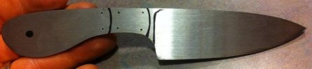

Here is what I'm thinking for the pin placement. I can source aluminum rod locally, or order nickel silver from several fine online retailers. Opinions? The big middle pin will be a mosaic pin. I might remove it and make two small pins in the corners.
The bolsters will either be nickel silver or black linen micarta. Handle material, something curly. Maple, Koa, something similar. Probably black linen and deep brown/red stained maple.

You're doing great so far. My one critical comment is that the placement of the mosaic pin seems a bit odd. I understand it (one big pin to balance the two small pins), bit it just doesn't seem to work for me. Maybe I'll feel differently when you've installed in and I can see it as something other than a black dot on a gray blank.
Something like this would be more what I would do.

Thinking more......I need to sleep on it, but I'm thinking of shaving the bottom like this:
Thoughts?
Shave the bottom off the handle like your marking demonstrates - really improves the flow.
I think omitting the mosaic pin is a great idea - too many details tend to distract rather than compliment. Red/brown stained curly maple with a linen bolster sounds spot-on! Keeping the weight down by avoiding metal bolster sounds smart to me, too - I hate heavy knives!

I agree that the mosaic pin doesn't seem to fit the design.
One big problem I see is the pin placement, especially the butt pins. They are WAY too close to the edge. By the time you curve the handle and sand things down, they will barely be there. This is a common problem that many new makers make. Save yourself the heartache and move them in more.
Personally, I would not double all the pins, but just use single placement on the center-line. Then you could use a mosaic pin if you want.
There is a reason the standard placement is centered - That way they don't get ground down and become useless or weak, as well as aesthetic flow.

I agree with Stacy on the pins following so close to the edge, especially on a piece that will have handle scales rounded off the way I envision this one. Another thought on the pin thing - maybe add a lanyard tube at the back, and a single small pin toward the front? That's a look I like, too. Almost all of these things come down to aesthetic choices of personal preference, but you asked! ; )
I've done some sketching on the blade. Matt can attest, my original design called for a single pin close to the "neck" and no bolsters. I'm headed back to that idea. I'd really like to do some new things with this knife, stuff that I've never done so as to keep challenging myself. That's why I added bolsters, but it's only 7" OAL. That a pretty small knife to start adding vertical design elements that break the curving horizontal.
Educate me on lanyard holes? It's down to either that or a hidden pin. I'd almost rather do a hidden pin towards the butt end to let the wood speak. I guess I don't know how to do hidden pins either.
More pictures soon. Hopefully I can get the handle reshaped tonight. If I get real adventurous, I might even do a handle mock-up from oak just to test the handle shape. For those who don't know, carpet tape works well to hold mockup scales to the tang while you test shapes and different stuff. I've used it before to great effect.
If you are using wood, not Micarta, for the handle, you may want to stay with the bolster. That thin neck on the tang can be the spot where a handle cracks, especially in a burl wood.
My suggestion on this would be one piece canvas Micarta or G10 handle in orange or red, with three pins. The center pin can be larger and/or a mosaic. I use three Corby bolts on a nearly identical knife I produce.
If it is to be a food prep knife, but for camp use, the Micarta/G10 will be more sanitary and hold up to the repeated washing and hot water better. The orange/red color will aid in finding the knife if dropped on the ground, as well as make it look "outdoorsy". A orange handled knife on the belt will look appropriate when camping. The canvas Micarta/G10 will also have a good grip for cutting tasks with wet hands.
Slight update. I had five free minutes and was able to sneak out and get the handle profile taken care of. I also slightly reshaped the front of the grip and plunge side of the blade.
I think it flows better now.
