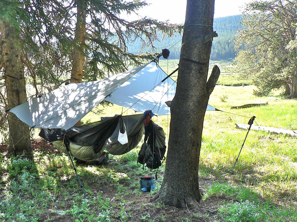

Neither of the other options has the fantastic warbonnet shelf. The shelf is a HUGE bonus - it holds a ton of gear, and helps keep everything handy inside your hammock.

I guess a tarp COULD be too big - if it's too long to fit between the trees or too heavy to carry, but otherwise you're golden. I actually own several tarps that my fiance and I use with various configurations. We each have a 12x10 tarp in the same design as a Speer Winter tarp, which can be closed up to give all around coverage for cold weather or privacy. We each also have some small tarps, for times when the weather is really nice and we want more of a view out of the hammock.
The Superfly is a great choice because it combines both of these options into one tarp. With the doors attached, you have a huge, spacious wrap-around shelter that will provide privacy and a wind block. Pull the doors off, and the tarp is still very big, with plenty of coverage for serious rain storms, but lighter and can be pitched higher to provide more air flow and a better view.
For us, the fact that we often hang together under a single large tarp made the modular superfly not the best choice, but if I were going to be hanging solo more often, I would definitely consider a Superfly.

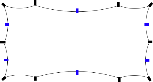

We use a 12x10 custom tarp made by Outdoor Equipment Supplier. Ours is cut in the same design as the Speer Winter Tarp, so it can be pitched in doors closed mode over a single hammock. In addition to that, I had Brian add some more tieouts, so we can pitch it in a variety of ways. However, we still carry two tarps - 99% of the time, we hang under this one tarp, but if the weather were really nasty, or there weren't appropriately placed trees for us to hang side by side, we can each have our own tarps.

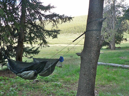

Here's a pitch where we wanted a flat roof between us for cooking and standing upright, while still having decent wind protection in case of rain. We ended up sleeping in a heavy downpour that night, and we used a rope to pull the suspension lines of our hammocks closer together under the tarp to give them better coverage, and stayed bone dry. In this case, the 4 trees we were hanging from were spaced pretty far apart, especially on the one end, so the triangle shaped flat roof pitch helped create more room under the tarp.

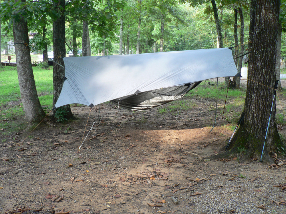

Here it is pitched for fairer weather, where we set the tarp high enough to stand underneath it comfortably. In this case, we were hanging from three trees, and they were spaced closer together, so a normal A-frame pitch worked very well.

And here's a diagram of how the tieouts are located on the tarp.
