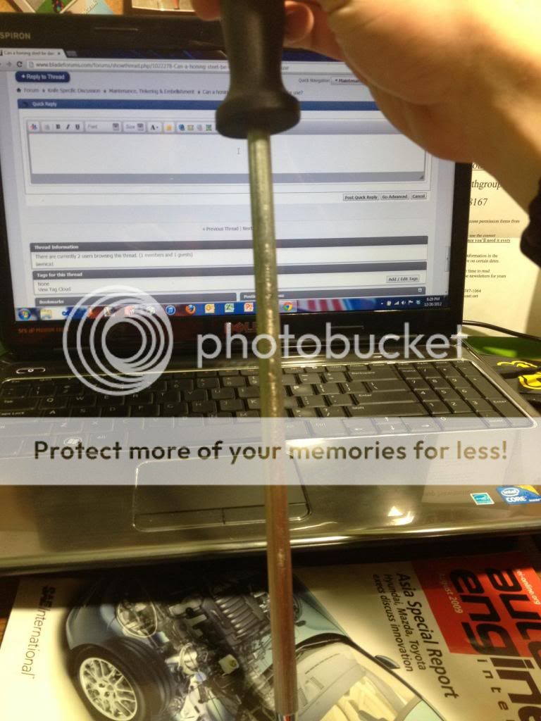

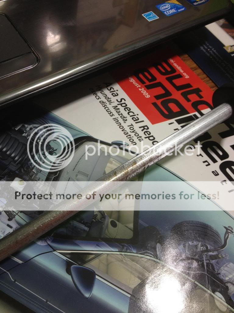

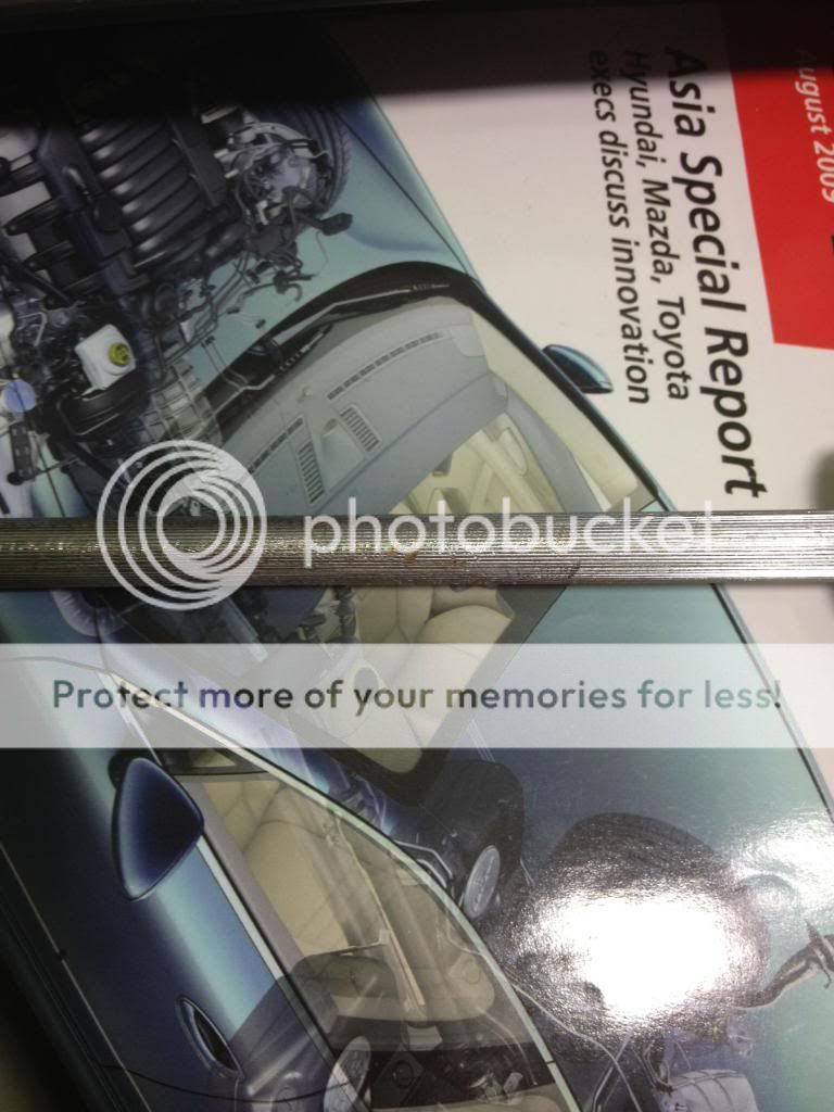

Thanks for the replies fellas, if it helps here is the honing steel in question... looks like a steel coating because the metal underneath is brass colored so sanding down will probably just make it worse. I know nothing about the brand or manufacturer because it is unmarked and my dad bought it.
I'm wondering if that 'brass' coloration might just be a little rusting of the underlying steel (under nickel/chrome plating; I'm betting it's chrome), or perhaps rusting of metal swarf embedded into it. I'd be surprised (shocked even), if even a 'cheap' steel was actually brass underneath. If it is rust, some Bar Keepers Friend cleanser would clean that up. Obviously wouldn't fix the dings, though.
That steel looks a lot like a couple I've seen included in basic, inexpensive kitchen sets, like the older knife block sets from Chicago Cutlery or similar brands. I'm pretty sure I've got one like it, and my parents also have one similar in an old Chicago Cutlery set (1970s/80s vintage).
David
The "brass" color is from the nickel/chrome plating. Copper is commonly used as a flash under-plate for tin, nickel, chrome, etc. If you were to sand it you would first uncover the copper under-plate, with steel beneath that. :)
It looks like a pretty cheap steel, though. I imagine that it's barely hardened, if at all, and they were hoping that hard-chroming it would make it seem hard enough to work for a while. If there is any hardening it's probably a very shallow case hardening.
