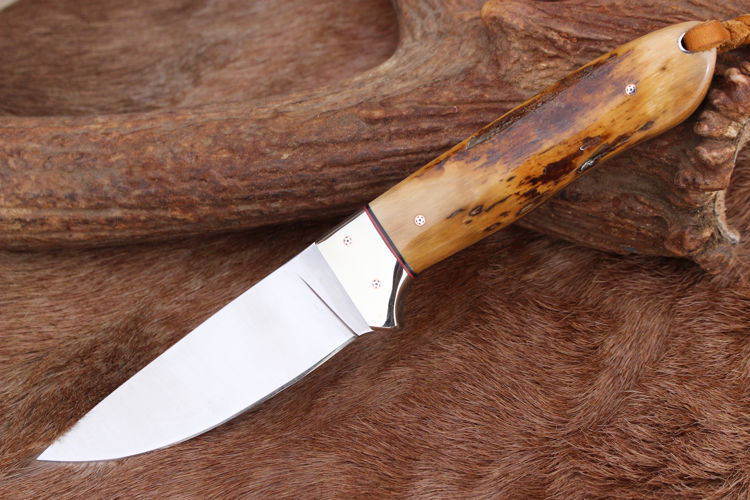

Absolutely. this skinner is down to almost a zero edge. 5/32" A2 @ 62 RC.

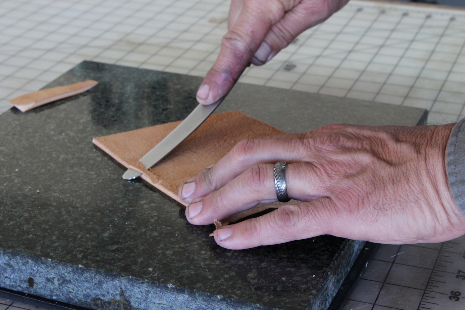

Absolutely true, Geometry and thickness provides flex. Not hardness. Leather skivving knife used to thin leather edges. The flex allows you to control the angle of the skive. AEB-L @63 RC so very hard. Designed and further refined by our own Paul Long (sheathmaker here on BF).
