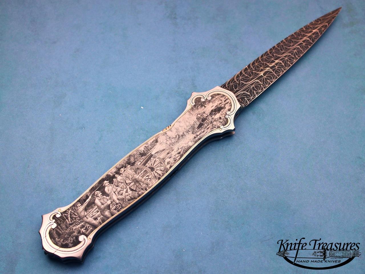

Can Anyone Identify this Damascus Pattern?
Jan 31, 2012
4,704
I have never seen this before and it's pretty mind blowing.
Thanks!!

The pattern in question is a 3 bar "Centipede". A maker by the last name of Smith has done several variations of Centipede patterns. This particular blade in the Kious folder is a whole bar centipede core with outer 1/2 centipede bars welded to the core. It is done with low layer counts. You need to use at least 25 square bars to make it look right. Adding more bars adds a tighter look.
I haven't kept up with Eggerling steel so what I've explained is my knowledge of Smith's work in South Africa on this particular pattern.
