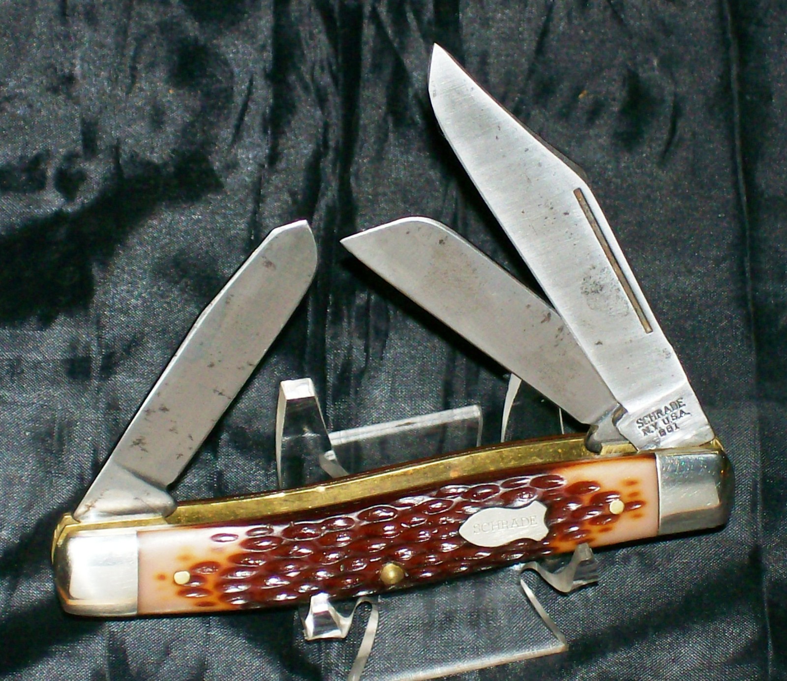

Can anyone shine some light on this “Pre 1965 Schrade 8OT”

This knife is for sale on eBay: $299.99 with a $60 discount; it could be yours for only $239.99.
image.php
The seller states:
“Pre-1965 Schrade Walden 8OT with Sawcut Delrin Handles with the Old Timer Shield and Brilliant Nickel Silver Bolsters with Brass Liners and Hardened Carbon Blades with a wonderful Patina lightly accenting the blades and springs. Made within the first five years of production this 8OT Senior Rancher doesn't appear to have been used, carried and most definitely never Sharpened. Factory edges and the factory Mill-cut on each blade with a Match strike long pull on the main blade. For time sensitive collections and Knife enthusiasts around the globe this is without a doubt a catch. It has been washed gently with soft soap and a soft bristle brush and this is the residue seen on the handles. A magnificent collectible and you could most definitely carry it as an EDC-Everyday Carry Knife if you wish. If you are a Collector or knife enthusiast then you're definitely going to consider adding this rare and early piece of Schrade Walden history to your current collection. YOU BE THE JUDGE”
As a Schrade Collector: collecting 8OT from 1959 to 2004, I have never seen a “Pre 65 8OT” Other than the 1959 Bone handled 8OT.
This is the reply the seller sent to my questions about this 8OT, they have for sale:

G'day Ken, the 1963 Schrade Walden Safari Sets, both style sets, contained similar 8OT's with Delrin handles, matchstrike nail niques and 8OT stamped on pile side master tang....for once that seller may have accidentally more or less described reasonably accurately except for condition.......nuff' said....ever bought anything at Airport Shops and wondered if they are ever in touch with reality with their prices?.....I suggest they are airport type prices on everything.....a donation for a perhaps worthy cause is another thing altogether.......Hoo Roo

The seller (ditwtexas) is a trickster. All of his descriptions are probably as authentic as his charity. No light to shed. All of his auctions are grossly overpriced in hopes of hooking a sucker. The 8OT is a typical Schrade Walden NY USA made up until 1973.

There is absolutely no truth to any single line of his description. Not any. Every bit of it is made up. And I am not talking about getting his information from a bad source. I am talking LIES. He runs a fake charity. I researched the charity and it is registered in a particular county in Texas and the legal entity which reports on these non-profits had his listed as "no activity ever at any time." He always has plenty of goodies for sale at 100% to 800% over common going rate and every one has a line of deliberate falsehood spread thickly throughout the listing. This particular 8OT was made from about 1960 or 1961 until 1973, as Hal said. There are tens of thousands of them out there. The part about sub-letting the handles is absurd. The company was Rogers, not Rodgers, and they burned down years before this time-frame. Schrade never sublet handles from anyone. The date 1965 has absolutely no relation to anything Schrade. Totally made-up. I could not call up the listing and his pictures, but I am guessing the residue from the "gentle washing with soft soap" is oxidation from laying the damn thing out in the sun. This man is an embarrassment to everyone connected with knife collecting. Possibly the worst of the villains on ebay.

The original question posed by Ken was ' I have never seen a Pre 65 8OT other than the 1959 Bone 8OT'.
My response remains the same to his question. It is factual that example of 8OT as displayed may well be Pre 65.
My 1963 Schrade Walden Safari Set has an identical 8OT in it. By identical I mean the following: It has Delrin handles. The same number of matchstrikes within that early production matchstrike nail nique. The 8OT is stamped on the reverse <pile> side master tang..and most importantly is the master blade swedge extends up and over the matchstrike on only the very earliest models 8OT's..later Schrade Walden's pre 1973 never extended up to the matchstrike....we are all aware the 8OT stamping was placed on 'mark side' tang later, and the nail nique became just a 'nick' on the master blade....
A quick check of lrv's pre 1973 Schrade Walden Flyers which are all dated will show the 8OT in the 1963 Safari Set.
I believe the seller may well be selling a Pre '65 8OT. He may have accidentally got his info right.
I also believe the bone 8OT may not have been made from/in 1959 when the bone handle 2OT and 3OT were introduced..may have been introduced in 1960+..

To the best of my limited Schrade knowledge, it is very hard to date any 8OTs down to a single year of manufacture.
I have 30+ 8OTs in my collection; I have 12 of the knives in question, all new in tubes and hinged boxes.
The Swedge on my Early 8OT is almost as long as the Match-strike.
After 1973 I have 8OT with different tang stamping (with the same wording).
Looking at this sellers feedback; most of the feedback is from sellers, the Buyers feedback is mostly missing detail.
Larry, you missed out on the 1965 Schrade 8OT; it has been removed from eBay. (even from my saved items)
Anyway he dose have this 1965 Schrade 881 for sale.
Most of my New early 881s (also in tubes) have Walden stamps, and match-strike pulls, the earlier ones have bone handles.
This "1965 knife" was made after 1973.
Ken, the extended back swedge to Master blade was only on the first few years production 8OT's so it is possible to date within about two years....its a handy tool to look for particularly if someone has rehandled a later model with bone handles......the swedge on the genuine bone handle 8OT Circa 1960 extends to within 3 of the last three matchstrikes....the swedge on the first two years production 8OT's with Delrin Handles extends over the first 7 matchstrikes in the matchstrike nail nique but not as far as the bone handle but substantially further than those 8OT's from the later 1960's...I have noted this is consistant.....if you have the original box's as well you can date the Old Timer hinged box by the knife it contains..
If you have 30+ 8OT's have a closer look at your earliest production models and see if this does not tally....
