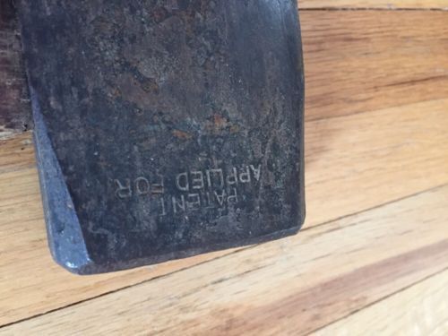

You've got yourself a lovely example of one of the earliest of the Plumb Nationals. Official copyright (or is it patent?) of this pattern dates to Sept 10 1948 but there are examples out there with 'Patent Applied For' (early 1948?) stamped on them and then there are also Victory versions that pre-date that. As I understand it Victory stamped heads are post WWII but that designation probably disappeared from Plumb products by 1948.

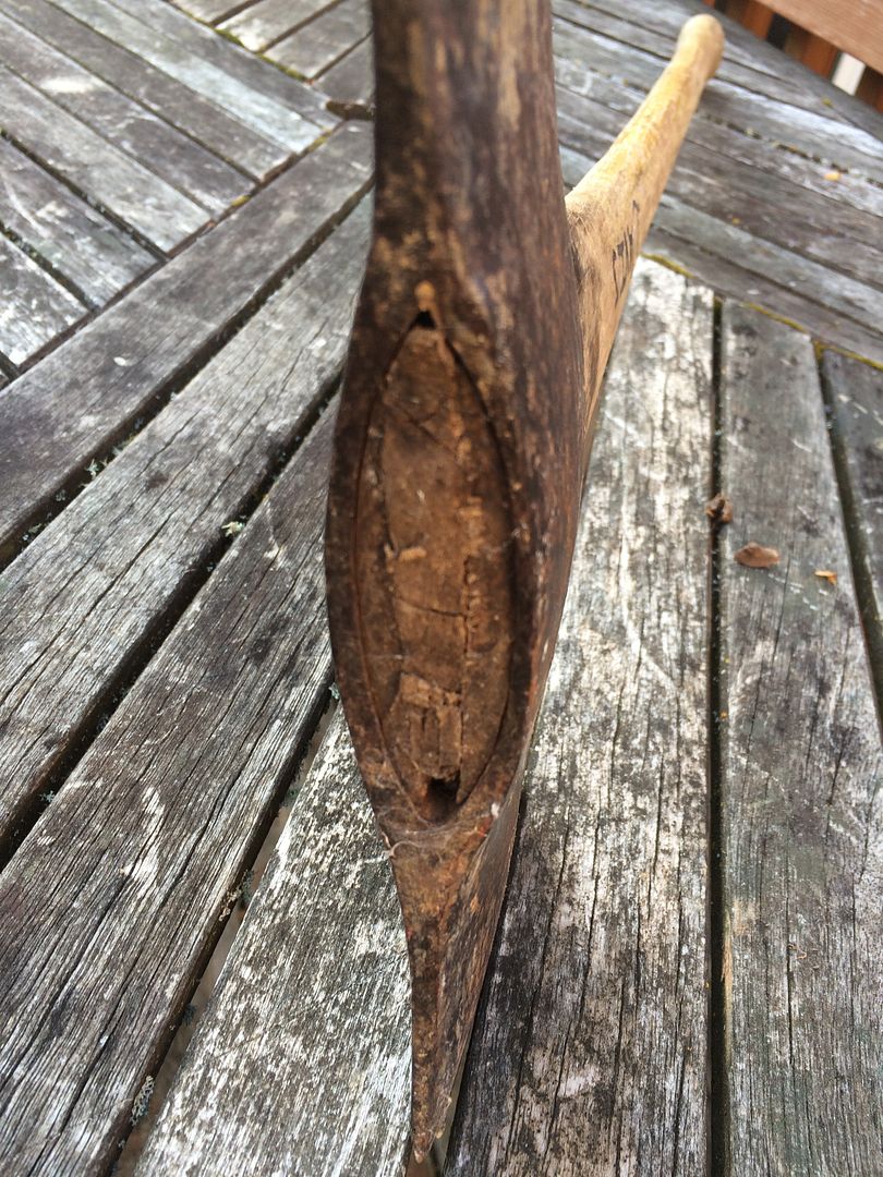

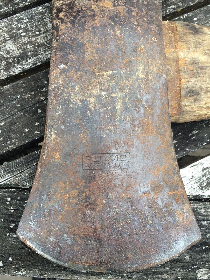

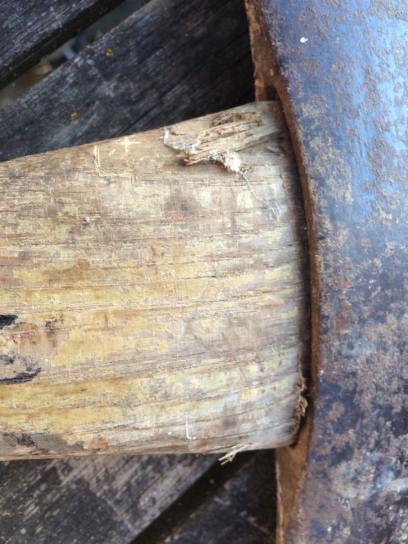

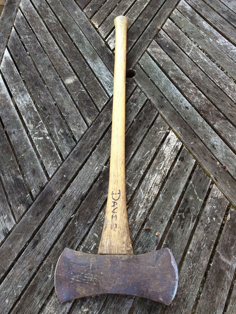

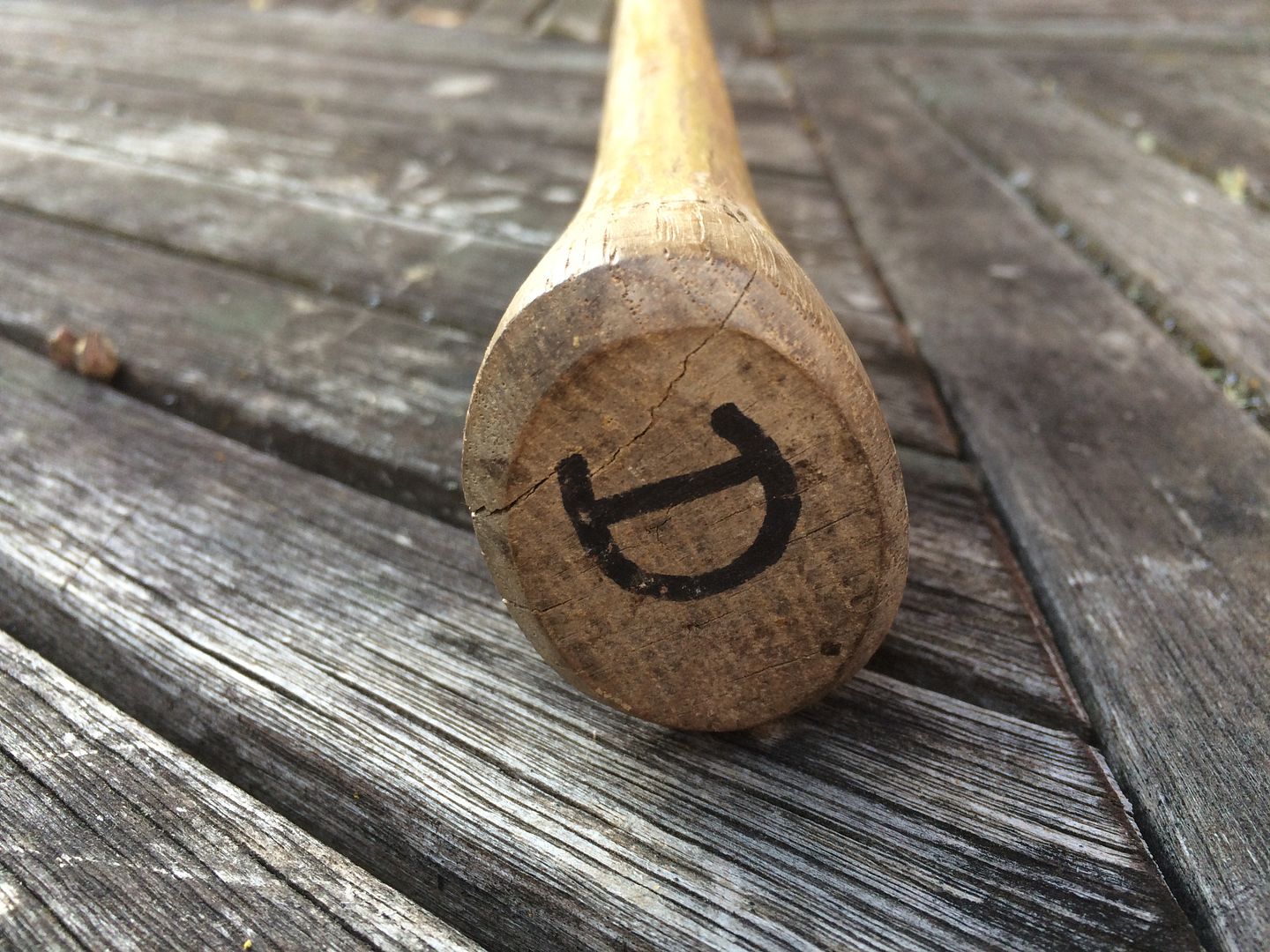

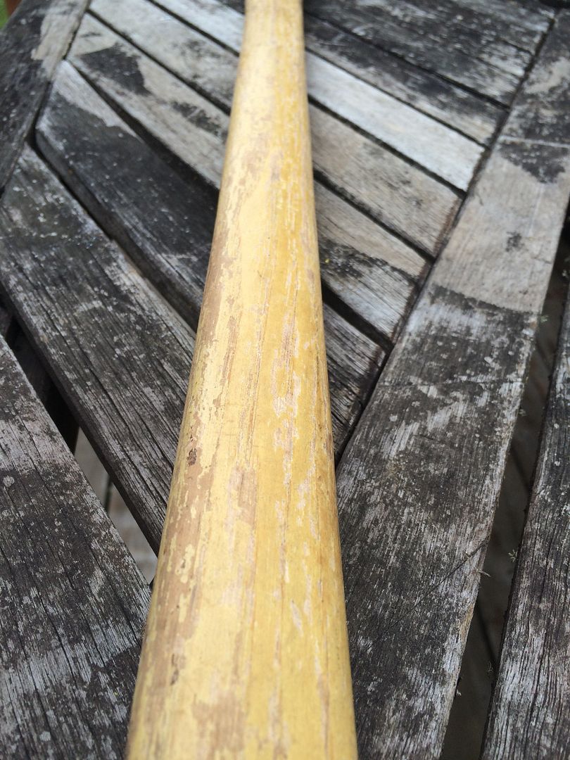

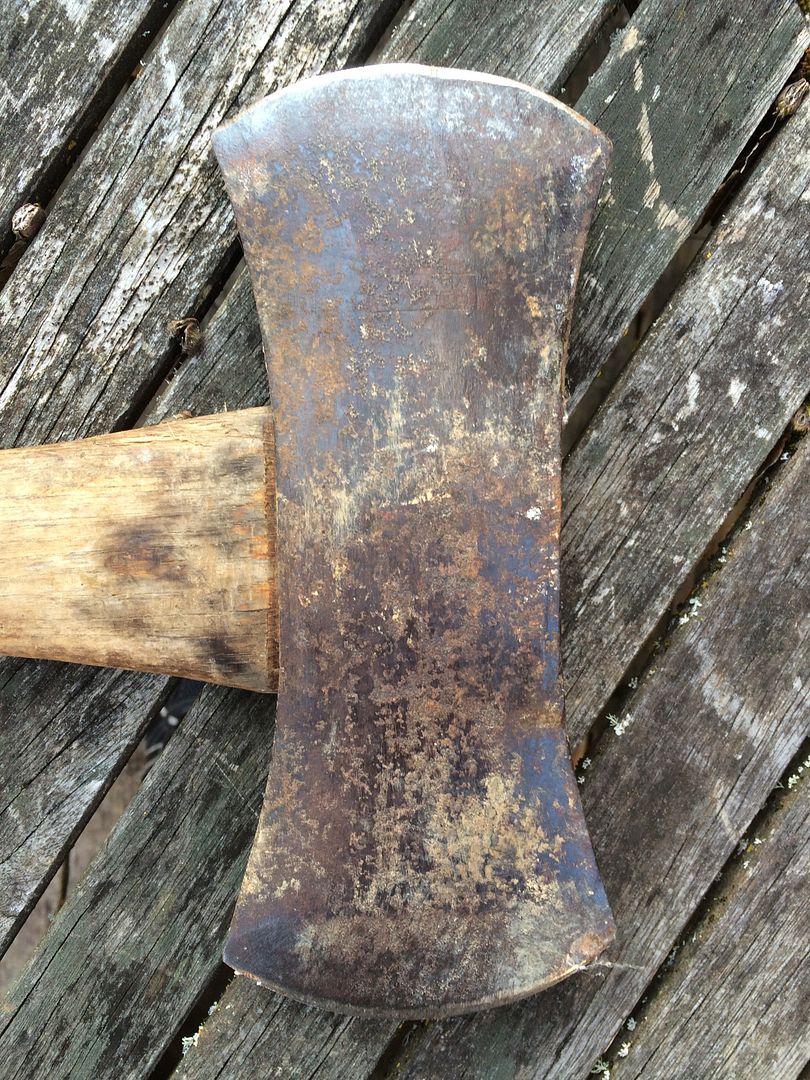

This one has been in the family for a long time but was just passed on to me. Here is a Plumb double bit my father said he bought after OCS in 1972. It’s been to Elk camp every year since. Two weeks ago I passed on to him a boy’s axe that I have been working on and he seemed to really like it.
While we were in the shop he dug around and pulled this one out. I have good memories of it and he figured it needed to be appreciated so he made me take it. There are several boxes of assorted hand tools that have moved with me since leaving home. Came across several that had my Grandfather’s name stamped in them and my Dad was happy to see them still alive – I think he now figures my garage is a refuge for all the tools he doesn’t use.
As far as he remembers, this axe was bought new and is on the original handle. None of use paid attention to that then – they were tools to be used.
Anyway, here are some shots of the old girl.
There is wear, the head is loose, and it’s relatively sharp. Not sure if I want to redo it or just seat the head and clean the edges. Don’t need another working axe. This one just might “hang around” in my garage for posterity.
He also passed on to me that it had two stickers – one on the handle that he stripped off immediately and one on the head that wore enough for him to pick it off out of annoyance. He bought it at a hardware store in Cottage Grove on his way hunting.
