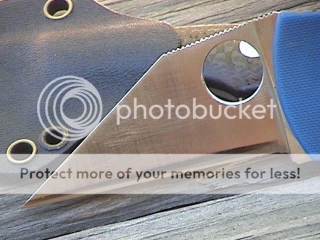

I say go for it, but I think I'd just thin and convex it freehand, versus trying to go all the way to flat grind it. I've done 'em both, though - sometimes you just gotta do what you gotta do. Despite the carbides, I've had good luck getting a nice poished edge on S30V with diamond paste on backed leather. Here's a thinned S30V yojimbo (weird but great handle!). I've used it cutting cardboard, tape, kydex,and the occasional jalapeno pepper. Admittedly not heavy use, but it has worked great.
that's a Krein TK-1 (in D2 :eek:) behind it...
