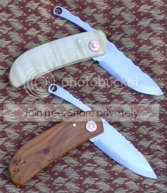

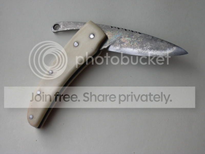

Friction folder was what I was thinking of. Something like a svord peasant or one of these (taken from bushcraftusa):

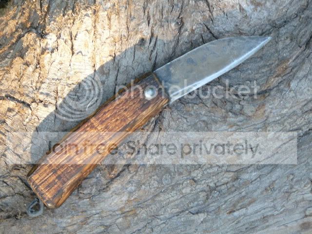

I have made a few of them, I like them too and carry this one at the moment:
This one has blued steel liners, bone handle scales and a 3mm thick, just under 3" long cutting edge blade.
Again, 3mm, under 3" long cutting edge.
I started making them because I wanted to be able to have a reasonably stout, "legal" knife I could use as an EDC without getting hassle from the cops if I "got caught" with a....erm, dangerous weapon!
Ie: under 3" cutting edge no locking blade. Unless you are stupid enough to go wave it about in a threatening manner, which I am not :cool: it's legal and no hassle should occur.
