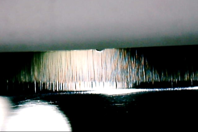

We have developed a method to differentiate wire edge from the clean apex - it is detailed in the Quality Control chapter of our Knife Deburring research http://knifegrinders.com.au/Manuals/Knife_Deburring_book.pdf
Even if you do not own a BESS sharpness tester, you can do a simplified test for wire edge by cross push-cutting a stretched fluorocarbon fishing line, and checking under good light or with a loupe if the very edge has got a micro-dent in the point of the cut – wire edge will dent, while the cleanly deburred apex will not. The fluorocarbon fishing line must be 7 LB 0.21 mm or near that.
This simplified method works for mainstream knives, but not for high-end hard-alloy steels.
Because the wire edge is too weak to cut the fishing line, it crushes on it and, as we increase the downward pressure, mushrooms against the line allowing to apply more pressure onto the widening point till the line gets finally severed. In the point of testing, we see a micro-dent in the edge with the mushroomed apex displaced to the dent bottom.
Microscope image follows, but this dent can be seen naked-eye:
