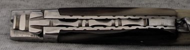

How To Can I loosen up a slipjoint knife after it has been completed?
ErikMB
Jul 27, 2017
870
I bought several French Laguiole slipjoint knives from Ebay. They are pretty nice but the blade and corkscrew are very tight. It is almost impossible to open the corkscrew and the blade is also pretty hard to open. Both snap shut too forcibly, as well. I am typing without using one of my fingers right now because it is bleeding and wrapped in a paper towel. 🤣
Worth noting is that the pin for the corkscrew is covered by the scale so I can't just just tap it loose by peening on it without supporting the other side (which worked for me on another knife with the same problem).
Is it possible to loosen up these blades and corkscrews without marking up the knives? Thanks for your advice!

Is it a too strong spring, or is it a tight pivot (with possible gunk, corrosion, etc.). Sounds like the spring. Let us know.
I wrap a paper towel around the blade and work back and forth adding copious amounts of your favorite oil (rem oil). Wont help with the spring tension but it is good general chi'
If the pivot pin is peened tight the oil and constant opening and closing may help. A shallow nail nick with a radiused ledge and stout spring can be frustrating.
With the blade/tool fully open use a well fitting file the same width as the pivot to slowly grind the pivot of the blade/tool to ease its resistance to open.
Where you are removing metal from is at the point the pivot first engages the spring. In doing this it has less spring tension and is easier to open. Works well but beware you don't need to remove much and you will need to extensively flush and re lube several times when done.
This works on half stops and ordinary opening knives. With half stops it's easier as you have a square 90 deg edge to file but works fine on ordinary too but is slightly more time consuming.
Hopefully these pics explain better than my woeful attempts at explaining :)
I've even done this on a new gec two blade jack that was annoyingly hard to open. Took 5 mins total.
Ps: all the above assumes you have not got an excessively peened pivot that is tight and is binding the blade. If so I tend to attempt to space the pivot apart slightly using careful leverage.
Wow! You guys are fantastic! Thanks so much for the advice! And the pictures!
I'm pretty sure it is the spring. There's no gunk in there and the blade and corkscrew snap into position very hard. There's a lot of potential energy that turns kinetic, if that makes sense.
