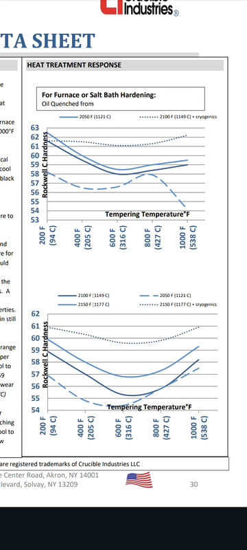

A question for you, do you have a cryo setup?
Here is a data sheet on CPM 20v and without cryo it looks like the hardness potential is pretty limited.
No, I don't have cryo. I was planning on using Larrin's recommendation for 2050 without cryo with a 300 degree temper.
I have never used the M390 steels, and never will, but if the data sheet is correct and you can only reach 56 Rc with 2050/300 I would recomend a different steel or sending out ht to a professional. 56 Rc is just way to soft for a quality knife.
I know it is fun to try different steels but it would be better for you to focus on one steel, dial down the heat treat and work on making quailty knives. It would be much better to make knives out of a boring steel that you can provide a decent heat treat for than getting your knives associated with sexy steels that are sucky soft.
