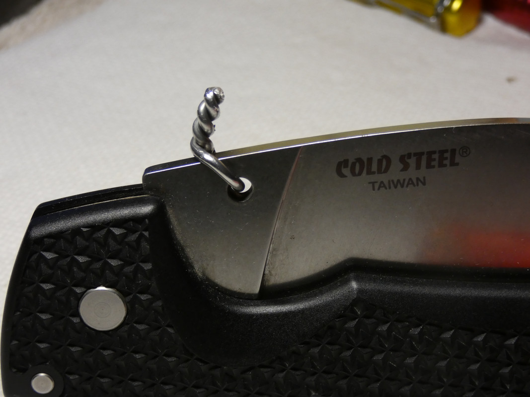

On the Voyager , two pieces screw together . Removed just leaves a non-threaded hole .
Pic is with studs removed for wav mod :
