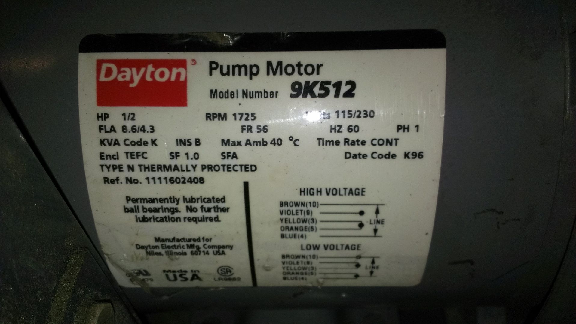

Anybody know how to reverse rotation of a Dayton pump motor Model #9k512? I can't seem to find anything on it on the web.. this is how it is set up and how I got it.
Usually terminals 5 & 8 are reversed. Often that is the red and brown wires. Look under the cover plate for the exact info, or download the manual ( unless you have the papers for this motor on hand).
there is no #8 or red cable... I guess it will just be easier too just flip the motor to run the other way.
