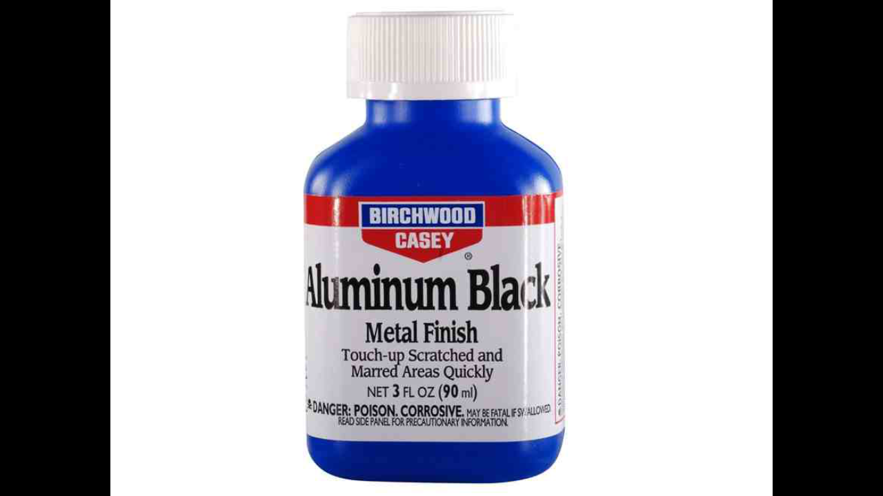

Try this stuff, works great on A2, I have not tried it on D2 yet... But give me a few hours and I will try it.
