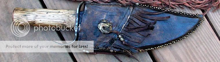

I agree with Mr. Leatherman, it is not good hide. I think they heat it and then roll which would produce hide glue, nasty stuff. But you can scrape and sand it to be more consistent. Depends on your time. I use some for rawhide tongs just because I got it free and apparently I have more time than sense. I used one of the huge three foot bones for this sheath, dyed with vinegaroon.
It is rawhide over veg-tanned about ten inches long.......Randy
