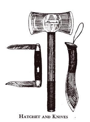

This is all Sears ever said of his knife. I have read pretty much all of his magazine articles and he says nothing about knives. He knew a lot more about canoes and loved his axe.
"A word as to knife, or knives. These are of prime necessity, and should be of the best, both as to shape and temper. The “bowies” and “hunting knives” usually kept on sale, are thick, clumsy affairs, with a sort of ridge along the middle of the blade, murderous-looking, but of little use; rather fitted to adorn a dime novel or the belt of “Billy the Kid,” than the outfit of the hunter. The one shown in the cut is thin in the blade, and handy for skinning, cutting meat, or eating with."
Pretty much all theories as to the origin are nothing but speculation. Some think it was a reground blade, some think he designed it.
All Sears left was this woodcut and his vague description. Unless someone can cite a source for their belief, those two things are all you have to go on.

Bruche hit the nail on the head IMO. Out of all the publications (most of which are out of copyright and on the web) there is almost nothing written about his knife. We know a lot about his axe, right down to his friends tung in cheek summery of what they considered his "poor business" skills. We do know how he liked to carry his knife however.

il bruche has it right - that's all we know...the rest is speculation. (nothing wrong with speculation....as long as we freely admit it :D)
Nessmuk did not design the knife....it is a traditional skinning knife pattern from the old west.
What he DID do was popularize it tremendously...
WE put his name on the knife...
much like we put the Bowie name on a butcher knife. ;)

Most of these "traditional/historic" designs I've seen have something near a 50/50 blade-to-handle ratio...
If you look at George's pic...the handle is probably only 75% as long as the blade...
