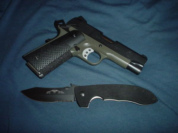

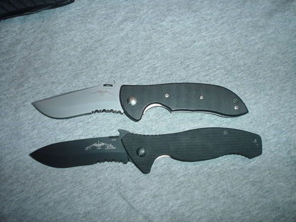

Emerson Knives has a feature on MOST of their knives that is a curve at the top of the blade(looks kinda like a ocean wave) that faces UP(blade it carried tip up as well). When you remove the knife from your pocket, the "wave" catches your pocket and opens the blade. It takes a LITTLE practice, but once you figure out the angle you need, the blade locks tight and the knife is ready to go.... It is VERY fast... It will amaze anyone nearby when the blade snaps open before it is barely out of your pocket. Makes my Benchmade auto's look slow! Look at the pics of Emerson knives below and look ate top of blade near where blade meets the handle scales. You can see the "wave like" feature.
