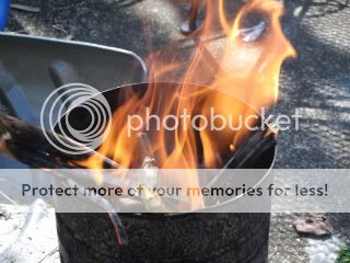

So today I got bored sitting at home :yawn: so I decided to make a fire in my can stove out back. Do any of you guys use these? Mine works really well!

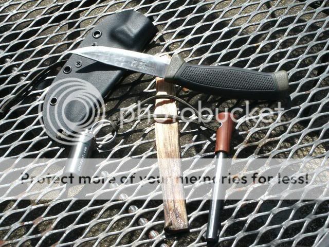

It was my first time trying just feather sticks and fatwood in the can, had to find a way to get the flame into the can. I used my Mora Army Clipper (carbon) with my excellent sheath from OnScene Tactical! I also used my GG Misch Metal rod which worked great once I realized my SS Clipper wouldn't work.

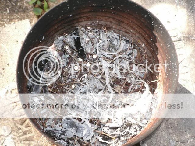

My stove is very efficient and doesn't leave anything but pale white ash.

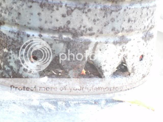

I made mine with a church key for the holes on the side, I face them towards or away from the wind depending on how big a flame I need.

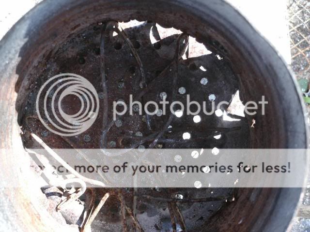

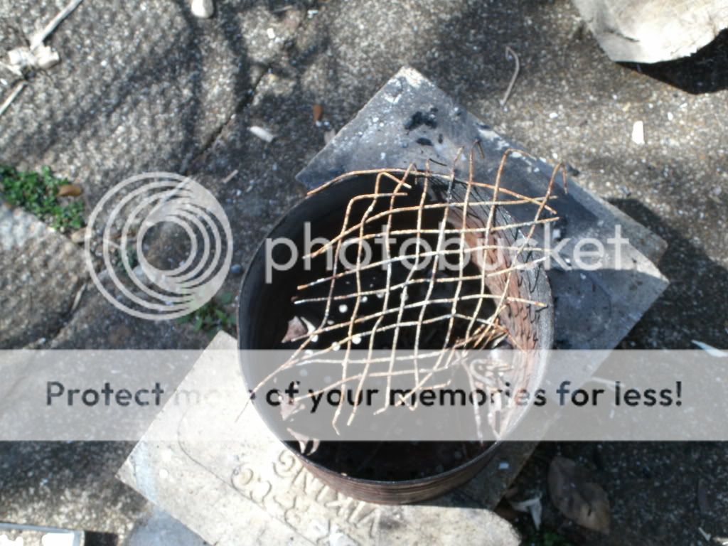

And I punched many holes in the bottom with a framing nail, so that as long as it has airflow underneath it creates suction which makes almost anything burn even green bark! I forgot to get pictures of the bottom but I got some of the spacer I put in the bottom of the can to keep the ashes from clogging the bottom airflow holes, you can also see the holes in the bottom a bit. The spacer is two part, first a tangle of folded wire.
Which holds up the piece of rabbit wire, which holds the ashes.
