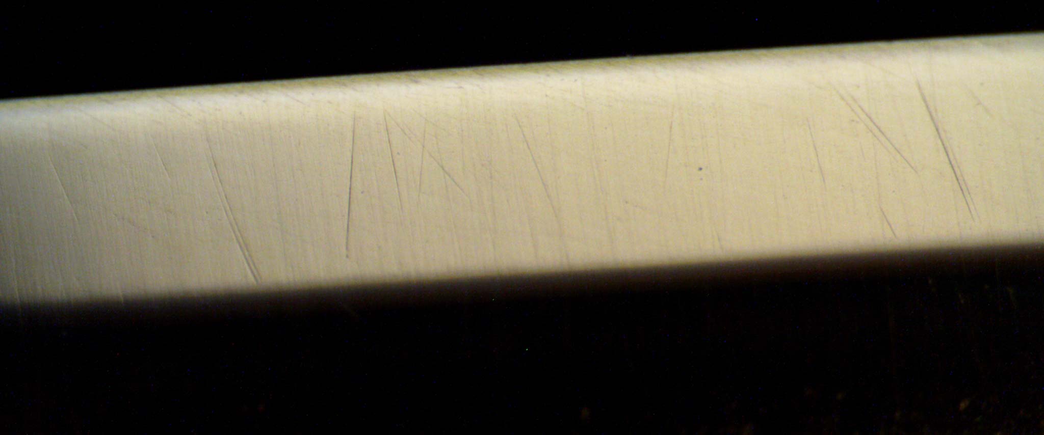

I found a photo of what 10 strokes with a 1 micron diamond loaded leather strop, using water as the carrier, does to a Maxamet blade after a 5 micron resin bond stone. I raised the angle of the strop 1/2 a degree which shows up half way through the bevel. The strop only polished the apex half. It doesn't look like much but makes it noticeably sharper feeling, just like going another grit on the stone progression. It push cuts cardboard nicely, for months :). For scale that bevel is about .06" wide.

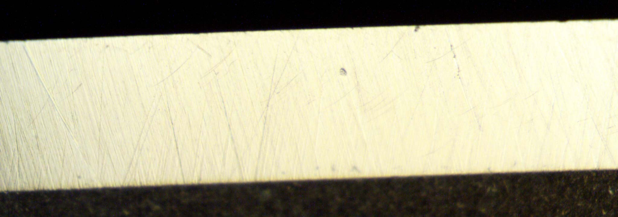

And here is what an over stropped bevel looks like. This is 440 or similar steel.
This is what is started as, after the 8 micron resin bond stone.
