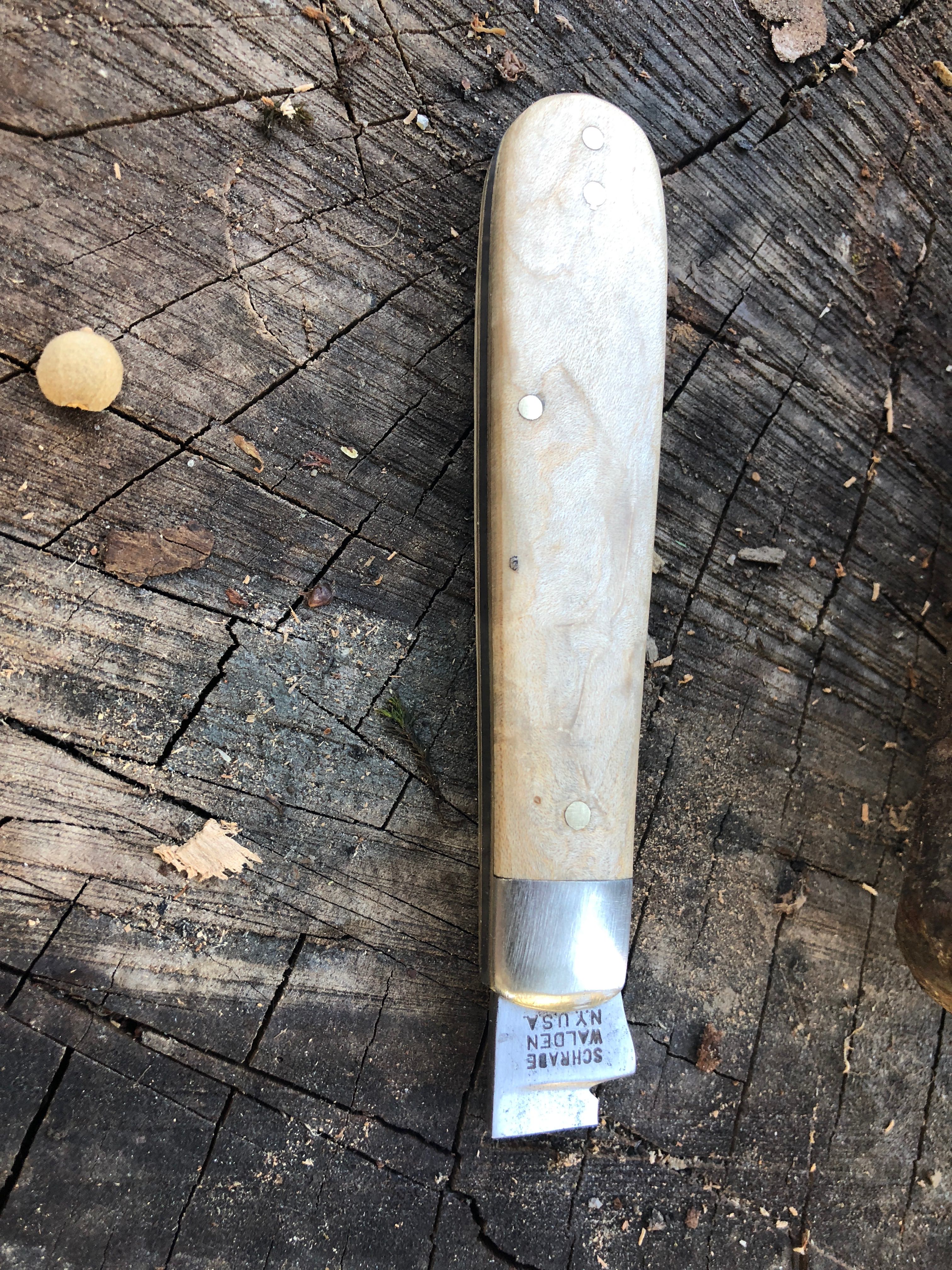

This knife came out when I decided to breath some life into it.
It had a broken scale and no snap left in the blade.
I thought I could regrind the base of the tag to sharpen it up a bit and give it some snap and make a nice carry knife since the blade had some life left in it.
Plus, I liked it. Everything went fine.
As some of you know these Schrade knives use a Swinden Key Pivot, so I decided to drill the bolsters and put it together properly (in my humble opinion).
OK. These are all common practices for knife makers.........
When the knife is as you see it now, about 80% done, i decide the blade isn't centered and I can fix that right up.
I know a bit about crinking but haven't had much luck with it so I decided to put a little bend near the tang (I've had success with this in the past).
As I was applying pressure I knew it was a bad idea. It was.
I've searched the forum and the net and have found a few example and references to crinking, but was wondering if someone out there has experience with it or still does it to a degree that they can actually show or explain their process.
Propping up blade, supporting points, how hard to hit.
Please share your wisdom on this seemingly lost art.
Reaching out.
Thanks all.
Rob.

That being said, I have done some minor crinking. Crinking is much more nuanced than "bending" which is almost impossible with hardened steels. In my experience, you can bend a blade (sometimes!) pretty far one way, but getting it back to straight can be a real problem as you have seen.
I like the stockman pattern and a couple of other multi-bladed traditionals. Sometimes there just isn't much realistic room inside the little case for 2 or 3 blades and they rub. So light crinking is in order. Here's how I do it, and no doubt one of the service providers will tell you how to do it correctly.
First, I NEVER hit any blade to straighten it. I don't take the knife apart, either. The thing I try first to straighten a blade is to put the blade in a heavy duty vise and see if I can close the vise as much as possible and straighten it up I center the are as much as I can in the vise jaw before applying pressure to spread the pressure out over as large an area as possible. I never try to get them perfect, so if I can the blade to straight enough to close without rubbing, I stop there even though it isn't perfect. If the blade is bent towards the tip, I will try and that is all that is rubbing, I try putting in what I think is the right amount of blade (practice... done by eye) and will gently try to pull the blade in the direction needed to keep it from rubbing. Sometimes that works and sometimes not.
If the blade is bent from damage, and is bent say halfway down the blade, or I am trying to get clearance inside the knife case, then I try a combination of both methods. Sometimes on a multi-blade knife that may be needed on more than one blade to keep the actual "crinking" amount to be as small as possible on an individual blade. Remember, the smaller the blade the harder this will be to get done right, and in the end you might have to settle for a bent blade, which if I can still sharpen it correctly I personally think of as character. Again, a blade will move a surprising amount when it damaged, but getting it back to the original fit and straightness can be met a dicey challenge. I would rather have a slightly bent blade than a broken one!

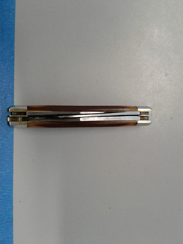

Crinking the blades seems to be a bit of a lost art. None of my newer Case knives are crinked, but my vintage 1980's Schrade 80OT is beautifully crinked.
Here's a severely crinked Schatt & Morgan. They should have made this a two spring knife instead of crinking the blade that much. It's actually even worse than it looks in the picture.
