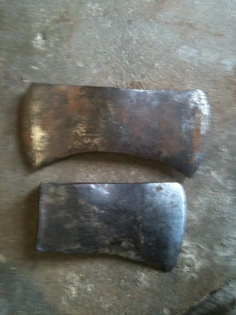

pics as promised
as found:

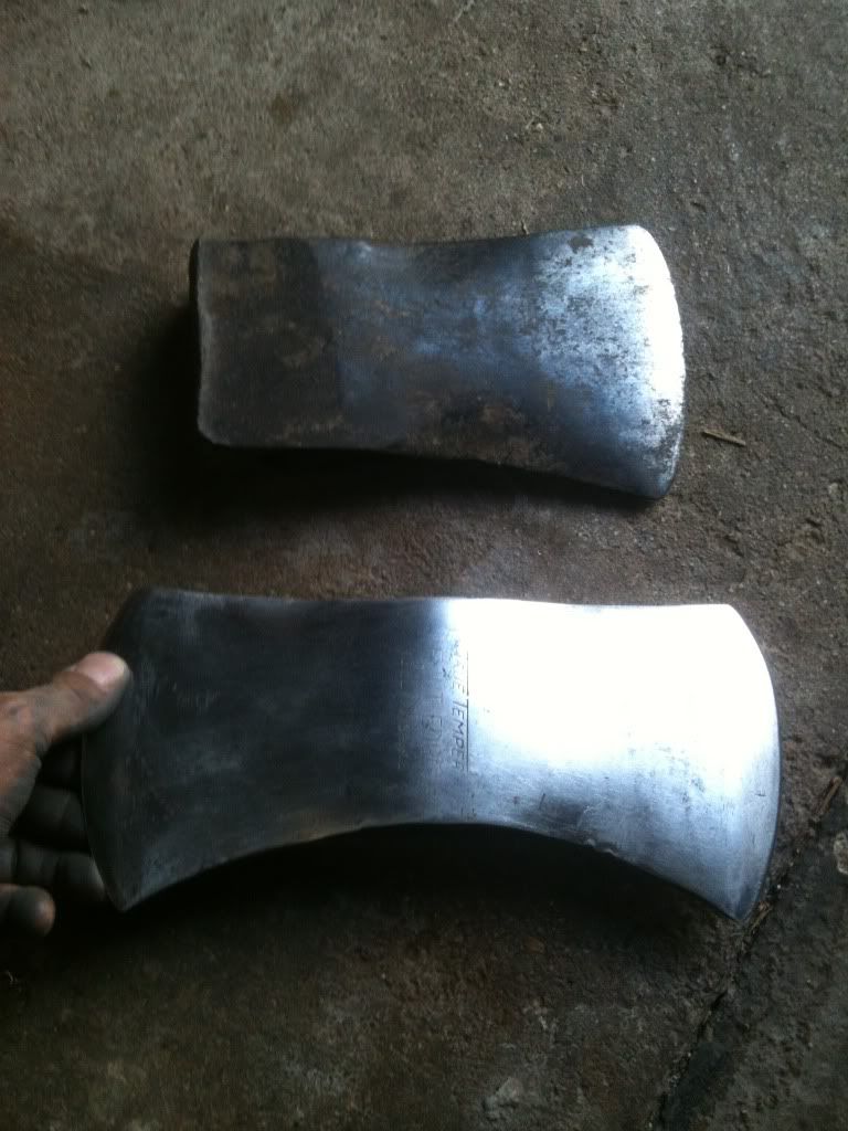

after a bit of cleaning up:

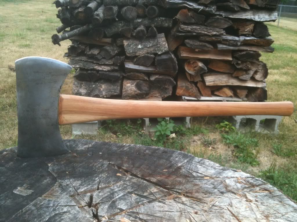

new life!
In reading up on the forum, I see many references to these DB axes as 'cruisers'. Why so?
You did a nice job on the TT Flint Edge restore. They are quality built fine axes. Cruiser axes are smaller than your Flint edge. Usually cruiser double bit axes are in the 2 to 2.5 lbs weight range and usually a shorter handle that made them easier to cruise the woods with.

By the way your SB looks like a quality piece even though no maker mark. although the eye might be a little distorted from the pole being pounded on. (or could be an illusion) A little distortion is OK as long as the centerline of the head is true and you can fit a handle to it.

Thanks for the info! I appreciate the details. But now I don't know what I have. I measured the head, it's 9 5/8" bit to bit with a 4 1/2" blade. Both local farm stores only had a 28" handle for double bits. So..... did I mess up?? Frankenaxe?
I forgot to mention that a cruiser size double bit axe head will have a smaller eye size than a full size DB. A cruiser eye size is about 2.25" in length. A full size DB will have around a 2.75" length eye. One can usually find full size handles in 36" and 30" sizes. A true cruiser DB handle is usually only found in a 28" length. I have ever tried to make a full size DB haft fit a cruiser size head, so I don't know if it will work.
Your DB head is most likely a full size head that has been sharpened down from a 10" size to the 9 5/8" size you have. A cruiser head will have bits that measure under 4.5".
Hope you got the right size handle/haft, good luck, Tom
Interesting. Again, thanks for the extra clarification. The handle filled the eye nicely, after the necessary sanding and shaping.
I hope it will be ok. The head weighed in over 3 1/2 lbs, measures in at a well used full sized double bit, but fit a 28" handle nicely. Honestly, I'll give it some work and see how it feels. You guys are a wealth of information!
