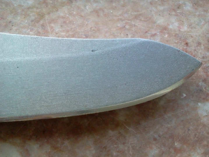

D2 with ferric chloride
edit: the pit you see there isn't from the ferric chloride but from some stupidity on my part
