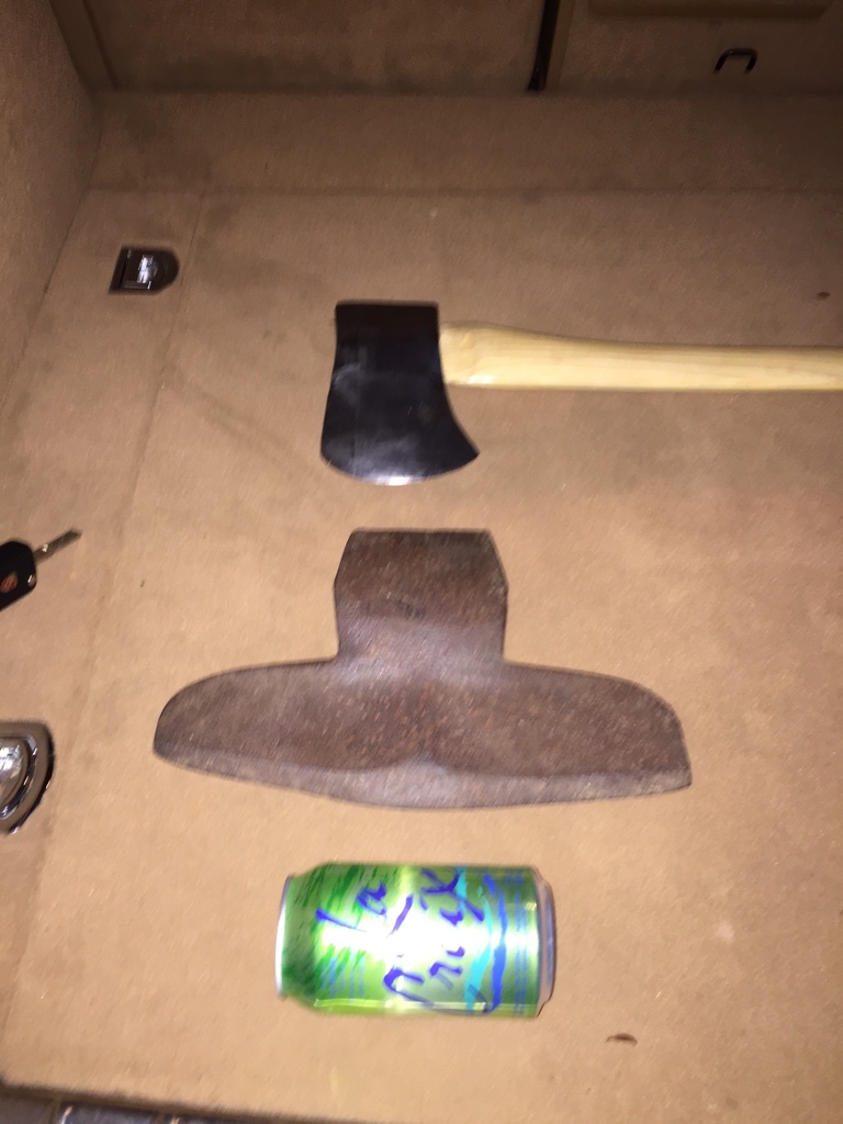

Can you guys point me in the right direction on a handle for this humongous axe?

Tennessee Hickory Products make broad axe handles. They have a retail outlet that has broad axe hafts most of the time.
http://beaver-tooth.com/collections/broad-axe-handles
All the commercially available broad axe handles I've seen are too long - 36". Should be 30" or less.
That broad axe is pretty heavily worn. If you want a user you might hold out for a better example.

Besides paying shipping on a larger package, can a guy cut a 36" handle down to 30"? Is the swell as important on a hewing axe as other patterns?
I have two hewing patterns, one needs a handle is why I am asking.
The one with a handle isn't offset. I've never steamed a handle but is that how you would create the offset if not carving your own?
Steaming or carving from a bent branch are the only ways I know of.

Right on, thank you. I've read your thread on restoring the hewing axe several times. That one and the alternative wedge system. I did miss the making of the handle - great stuff.
Your broad axe is well used...But still in fine working condition. The pattern of your broad axe is called a "Whale Tail".
Hang it and have fun.

Thanks and thanks for info on the name! I'm definitely going to hang it if nothing else to hone the skills, with you guys help I hope to do it properly!

Thanks man that is a cool pic im so pumped on this thing, I just ordered the handle from beaver tooth as you guys suggested. I know this is a dumb question but how much clearance should there be between the wood and the metal at the point you drive in the wood wedge into the kerf? Should it be able to move around?
