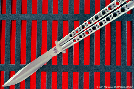

<font face="Verdana, Arial" size="2">but the darn camera takes in tons of light and it just finds more </font>
The picture shown above was taken with 1500 Watts of light. Light is your friend.

Cripes!
Look at those! You guys make me sick
~Dave
"One in the hand is worth two in the sheath"
Holy crap!! That's the 3rd pair of pants I've soiled in 2 days!!!!
Those bowies are just beautiful!
