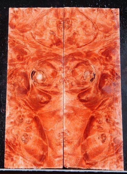

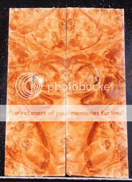

I bought a set of spalted burl maple blanks pre-stabilized, and in person the color is slightly lighter and more golden then I'd like. I'm guessin NO since it's all pretty much sealed now but if it is possible what do you use?
pic 1 actual blanks and pic 2 "using photoshop" is what I'd like to get towards "or maybe a little darker"
I suppose you could try. Working a little oil or wax onto finished, stabilized wood will darken it up some, but it will wear off with normal use. If the wood actually soaks up stain or dye, it's not really stabilized very well.
Alcohol based leather dye will do exactly what you want. Wipe it on, and wipe off the excess shortly thereafter.
The Afzelia burl I used on this integral handle was a little lighter and more orange-ish than I wanted. I've used the leather dye trick on about 20 handles in the last 10 years or so and it has done what I wanted every time. Just be careful, and preferably test the dye, color, and penetration on a scrap corner of the wood BEFORE trying it on a finished handle!!! Make sure the test sample has the same surface finish as you intend to put on your handle also, or it won't penetrate the same.
