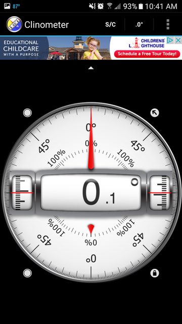

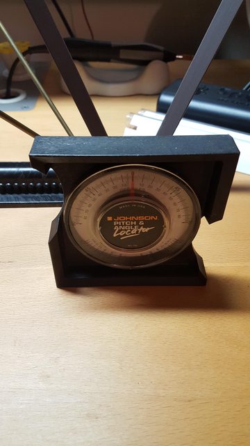

Try one of these if you really want to know what angles each side of your SM really is. Just make sure you're checking it on a level table or check the table first and add/subtract the table angle from the reading you take on each side of the SM.
I think I bought this one at Home Depot several years ago for less than $10. Digital angle finders are available too if you want to spend a little more money. The one shown below has served me well for years and I don't use it very often, so I haven't bothered to upgrade to digital.
There are also several angle finder apps you can download to your phone. They seem to work pretty well. Just make sure your using a flat spot on the side of your phone where there are no buttons protruding.
I've had a 203 SM for over 25 years that has some miles on it now. Both sides measure 21°. I honestly don't know if the angles have changed at all since new but both sides are the same so it's fine IMO. I have a new 204 SM and both sides are right at 20°.

I used to get the same edges shown in the OP, after a lot of head scratching, blaming my technique and mucking around I found that my SM base is out of whack, so now I have to tilt it to get even edges. I checked this by using a sliding bevel, propping up the base till the stones were even and now I get nice even edges. Perhaps your's is the same?
