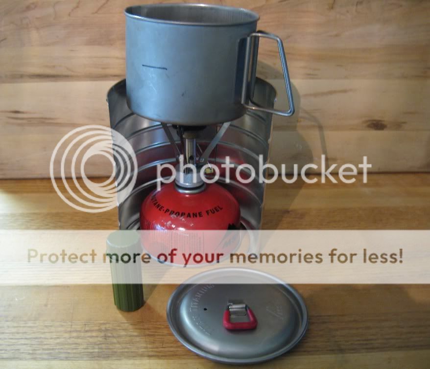

I weighed everything seen in the bag below (with two instant coffee pouches and two creamer pouches added), and it all came in at 20 ounces. Not terrible. I can still do things like...
I don't know if the tripod is entirely necessary, but I like it with my set-up, particularly because I have a taller pot.
Here's a link to the mess kit being tested: http://www.bladeforums.com/forums/showthread.php?t=786678
I wouldn't lose the Piez0- it doesn't weigh much and like you said- very handy
I've never found a need for a pot holder w/ the SP pots- at most I put a light glove, normally the pot handles are luke warm
the windscreen works well, but it weighs quite a bit- I made a Ti one that works as well and weighs a lot less
