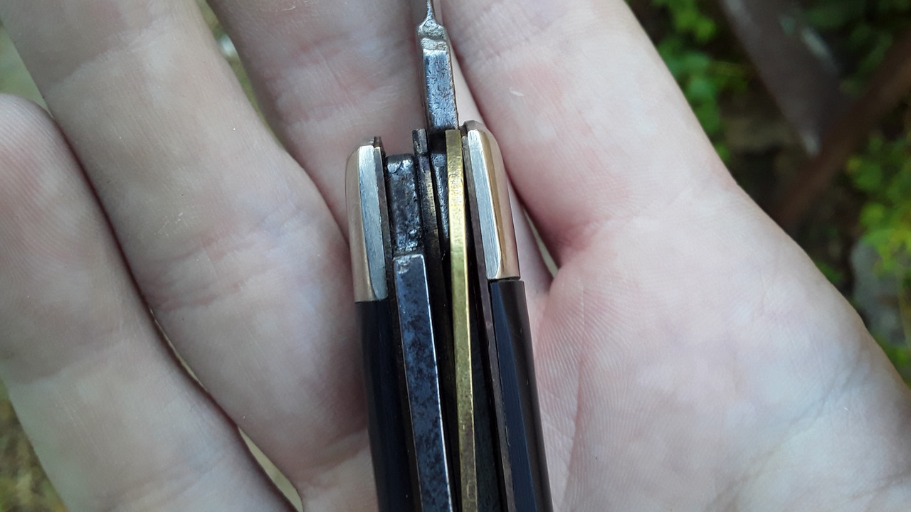

The knife has a liner lock mechanism.
This knife should give you a good visual representation since the it's liner lock is brass and easy to see.
The liner tab springs over to block the blade from closing, push it to the left out of the path of the blade, and you can close it.
