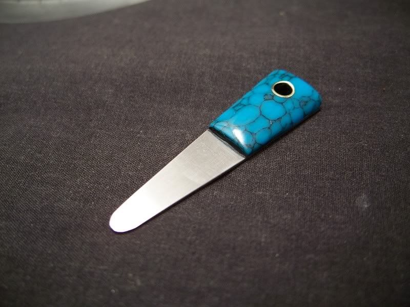

sounds like you need one of these :)

muskrat man, what is exactly is that? Does it work well, as in comfortable to use?
It's a knife pick. They are very comfortable to use and a very affective tool for opening knives with stubborn springs.
I received something like that (minus the stonework) when I ordered my File&Wire Gunstock from Bill at Cumberland. I had no idea what it was until I read this. How do you employ it?
